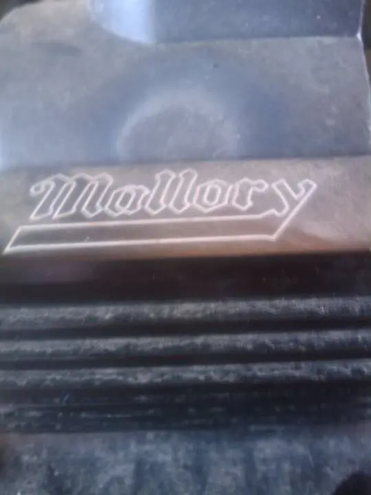

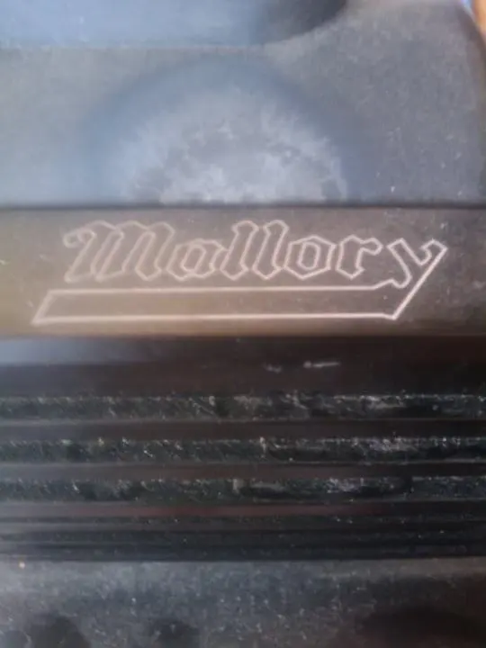

I bought one for my truck back in January. Monday night I noticed it was shooting sparks from the cylinder part of the coil to the metal part. You can see in these pics where it was making burn marks.
Well I call Summit and they say "that's not suppose to do that we'll send you a new one". I got the new one yesterday and installed it. I didn't drive my truck till this afternoon. I had it running today to top off my coolant then shut it off and got ready for work. I drove to work which is a mile or less and parked it. Came back around 8:30 fired it up and wanted to check my coolant and the new coil is doing the same damn thing.
I called Summit and the guy said sounds like it's your wiring cause you can't have two bad coils. Now I have to call back tomorrow and talk to a tech person.

Update on this. I called Summit and the tech guy asked what I was using it on. I told hime an 01 Dodge Ram 2500 and he was like oh. Did some searching and said the that ohms were off of what I need for my truck. He looked and said they would send me one that will work. The are sending me an Accel coil. I'm not very happy about that cause I've heard bad stories about their stuff. I guess we shall see what happens
