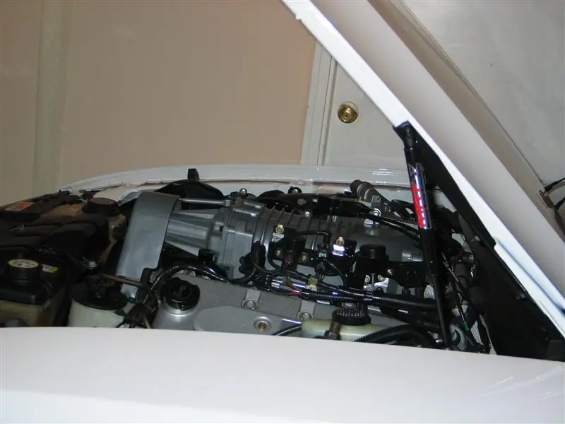

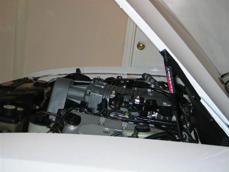

P.S. The MRT's will just like this on your white Terminator... :D
