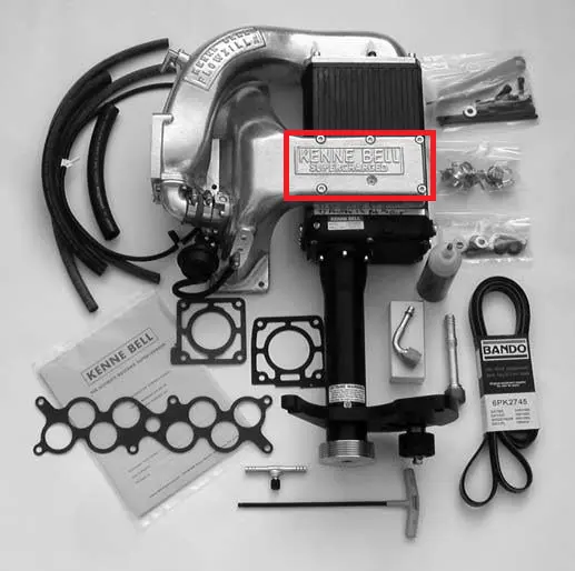

FastDriver said:
pressure hat?
Reactions: FastDriver
FastDriver
I was uncomfortably high & wearing a helmet
SN Certified Technician
Sep 5, 2001
6,193
2,847
224
Vass, NC
Jun 5, 2019
#62
  • Jun 5, 2019
  • #62

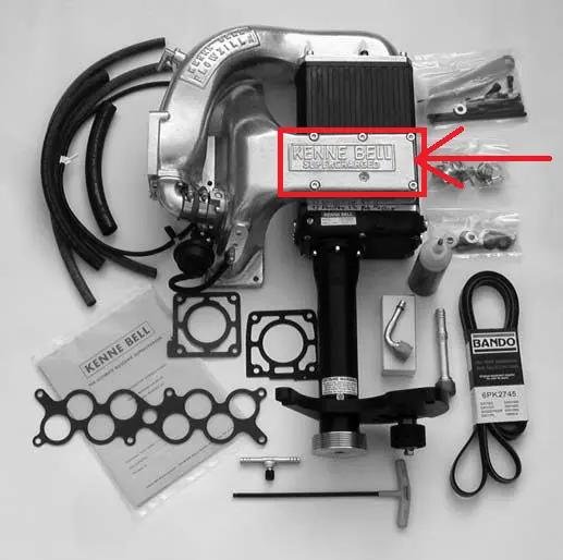

Looks right to me Steve. Could mount a nozzle to the left of the KB logo.
Admin Dude
Jan 4, 1985
43,499
21,672
Box behind Walmart
Jun 5, 2019
#63
  • Jun 5, 2019
  • #63
I'm planning to mount mine into the manifold from the right side:
It will [have] to mix with blower air in order to proceed.
