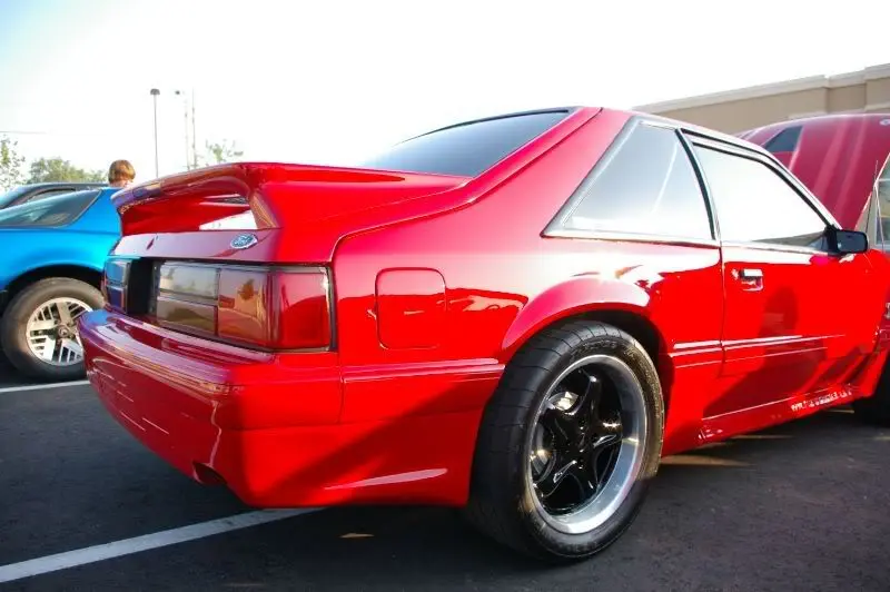

My coupe before
and after
I went and got some flexible build primer, add a coat and sand a little. I did around 40 coats. Then my final coat was a semi-gloss black (try and find flexible paint, like trim paint).
Bingo. With the flexible primer, you can actually fill in some pretty pitted stuff. Just takes time and patience. For the actual paint, I went with a semi-gloss bumper trim paint. Turned out great. I'll try to get some pics up later.

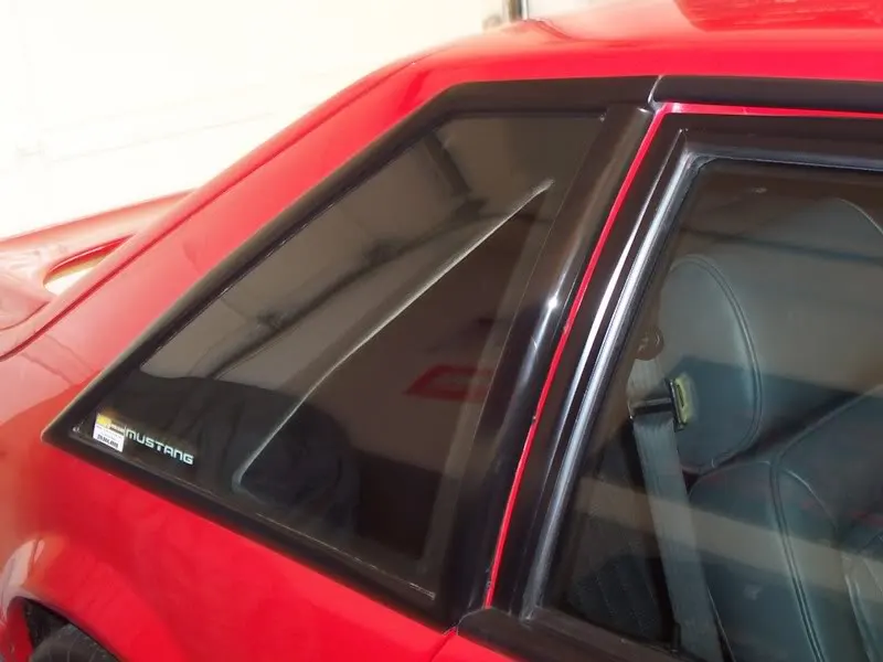

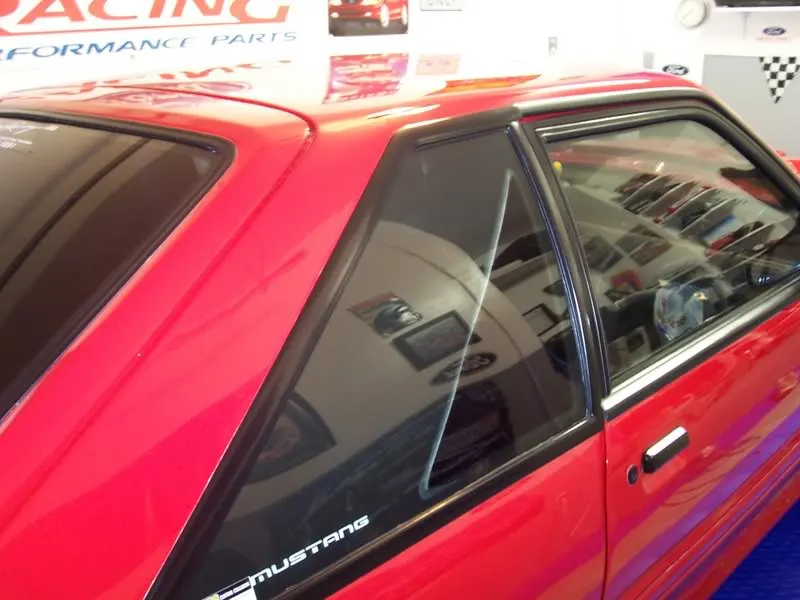

Well I have to disagree with them looking bad, infact from every show I've attened...including the cruise nights, no one has ever noticed them. Not noticing is the ideal response you want with them, only comments are on the positive side regarding my trim condition of the vehicle. As for appearance.....
Those looked better than the ones I have looked at, but they still stick out like a sore thumb. I would just fill them with build primer and paint them.
