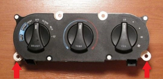

I got a lot done on my list. The oil leak had to be addressed. One of the next things is putting the stereo back in. That includes the whole system that's currently sitting in a plastic tub. I've always wanted to have the radio where the HVAC controls are. I hate not being able to see the face of the radio very good. While I was working on the other stuff I completely removed the HVAC knobs and controls. I put them down where the radio normally sits. I've been wanting to do this to see how they fit considering they are wider. The two lower white plastic tabs (red arrows) will have to go to fit. Surprisingly though, the bezel that snaps over them fits perfectly if you put the controls where I'm talking about. It leaves plenty of room for the radio in the place where the controls were. I do not have an airbag module like the later cars. I am also using a JVC head unit that is digital only....no CD player so it is not nearly as deep.
My question is this. Do you guys think it would be worth the trouble to swap the radio/HVAC controls? It seems like not very far. Sling some input at me if yall will please.

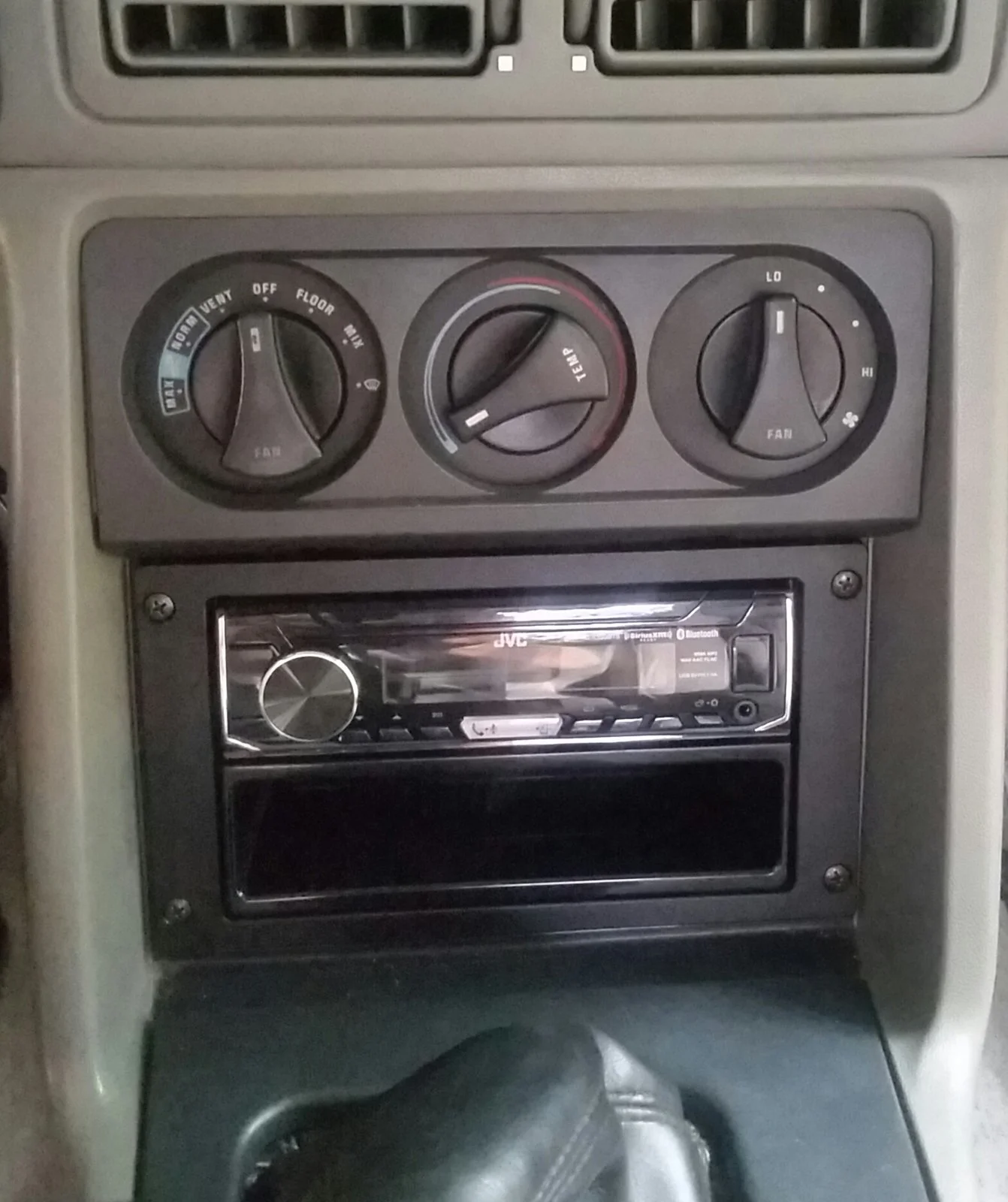

Ok....got the stereo in. I went with the simple option for now. If I want to swap it around later I will then. It just a JVC Arsenal Media player. No CD. Has USB and Aux 3.5mm on the front as well as Bluetooth. I bought this a couple years ago and have never put it in. DONE.

The new ground I put on goes from the back of the head to the firewall. It didn't fix the gauge randomly floating around.
The pic above is how I decided to leave the stereo and hvac controls. Sorry I don't have more info than that but that's all I got for now bud. Thanks for asking though!

I watched a youtube vid of a guy who did a relocation and it looked pretty clean and easy. He even sells the plate for $45ish on ebay.
View: https://youtu.be/D-E8n1S4cQg
His kit is for the 90-93, but I think it could be adapted for the 87-89 easily. It's interesting how the HVAC controls bolt into place at the right spot to allow the plate to sit and hold the radio.
Only reason i'm not doing this to my car is due to the rather permanent nature of it. Would it be more usable? yes.
