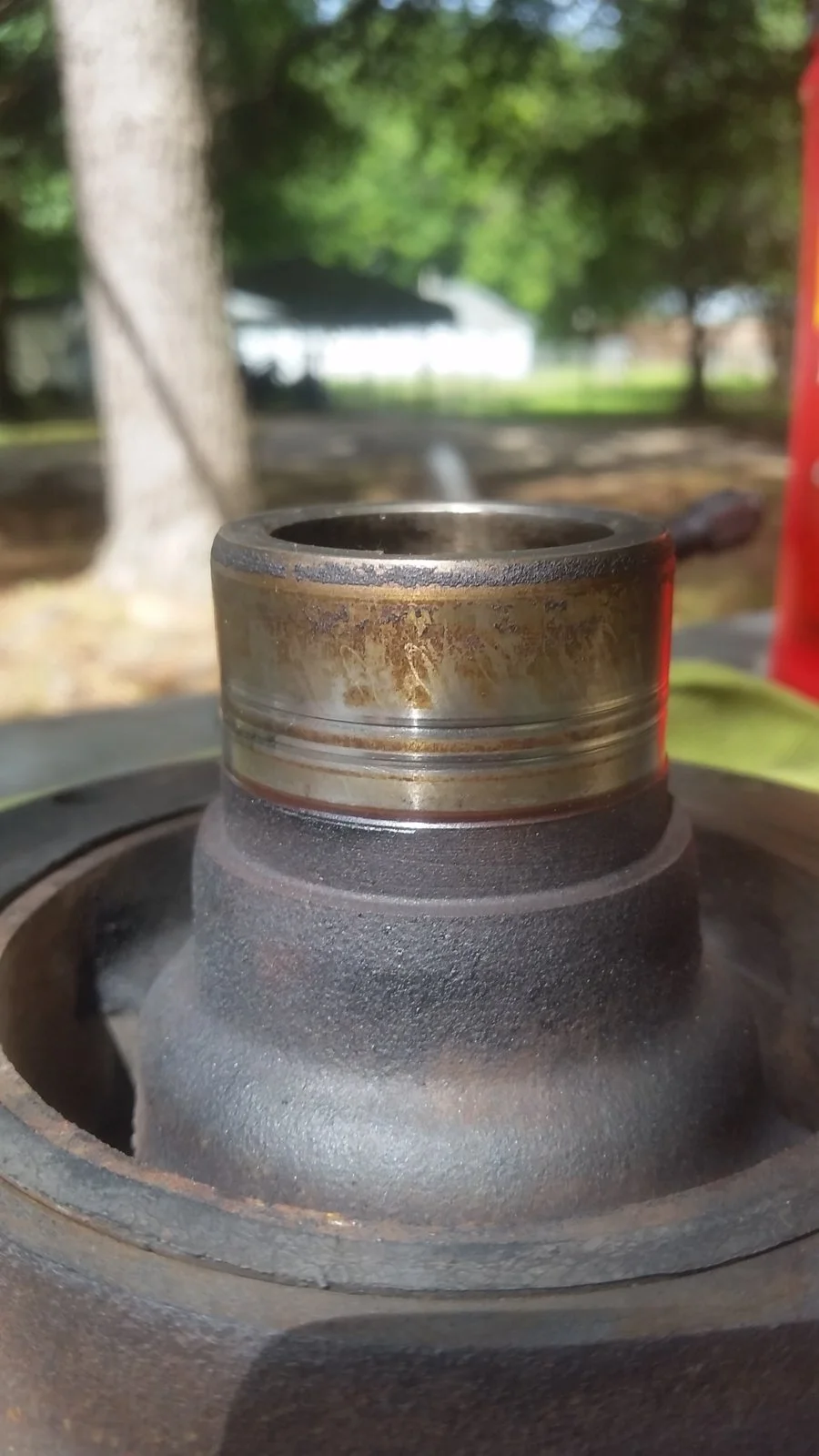

I'd be curious to see if a groove has formed on the balancer. In that case install a sleeve, or if the rubber is cracking and pushing out just replace the balancer

+1 on the balancer sleeve, It has solved my problem before on a 60 yr old 289

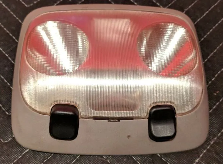

-New dome light and other interior lighting to really light up the interior (Get a dome light from the wrecking yard. I'd like the '93 Mustang version but need to know what all vehicles they are the same in since there are zero foxes in the yards here.)
I'm working on my list and wanted to get info on one that hasn't been addressed yet. I've searched around and can't really find good info on this one. Does anyone have a list of what all vehicles this part came on? My '88 has the small rectangular one and I'd like to put on of these in. the 92/93 Mustang I know but there are none in yards around here. Thanks.
629737
I think other Fords of the same vintage had it as well. Taurus or escort?
Search "92 Ford dome light" on eBay and see what comes up for what vehicles.
Edit: looks like explorers had it and part number is F1DZ-13776-F.

Sounds like the same issue I have with my Cobra. The balancer is grooved and needs to be sleeved. If it were me, I'd just go ahead and buy the sleeve and, no matter if I was changing the balancer or re-using the existing one, I'd install it before putting a balancer back on it. I'd like to think that the sleeves are hardened to prevent wear. If, for whatever reason, it DOES wear through, it wouldn't be all that hard to replace just that sleeve again. For roughly $10 I think it'd be worth it to go ahead and do it in your case. Oreilly's offers them, but you may have to order it. Looking online at my store it says available in 24-48 hours. Another parts house may carry one in stock?

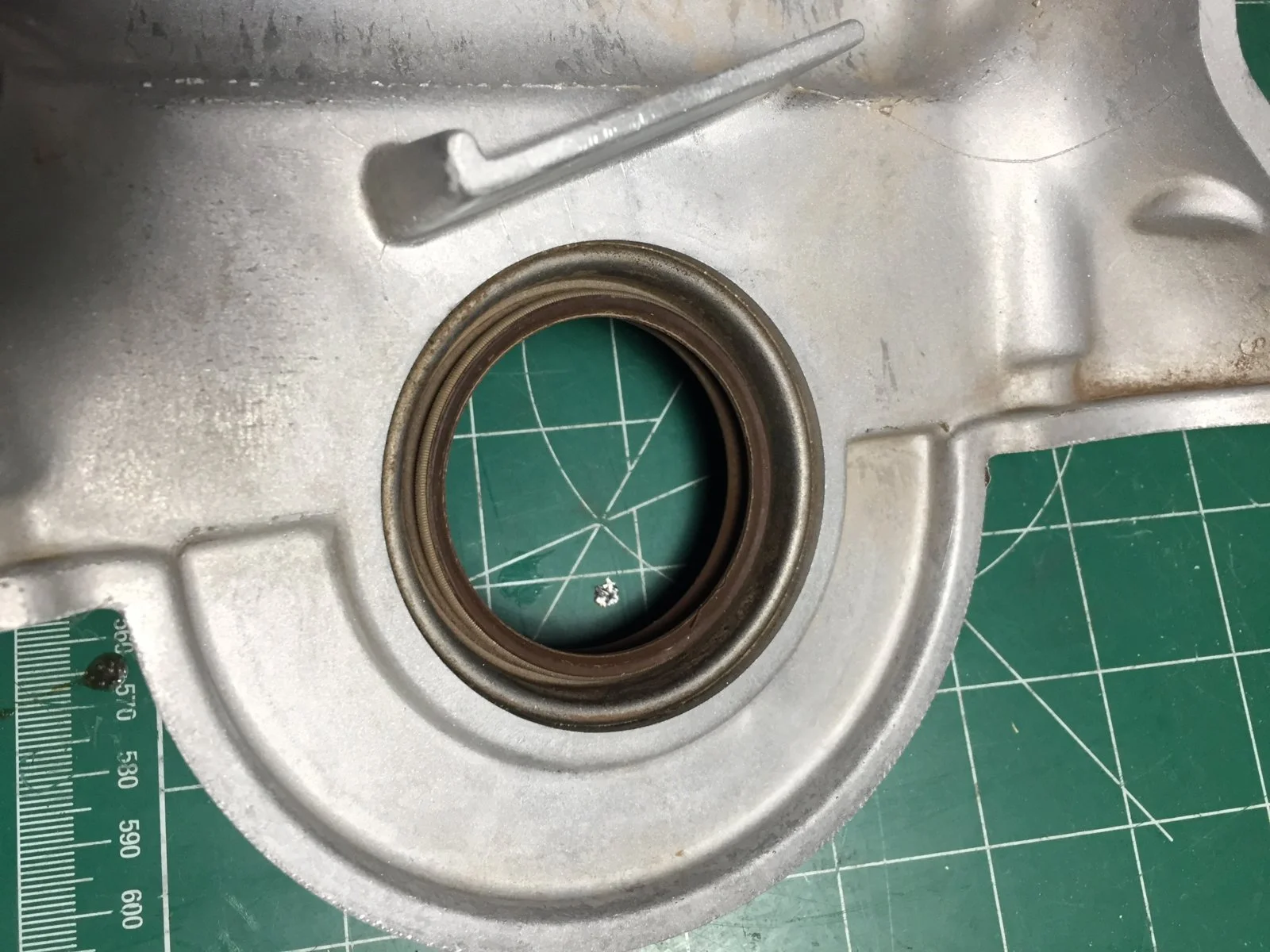

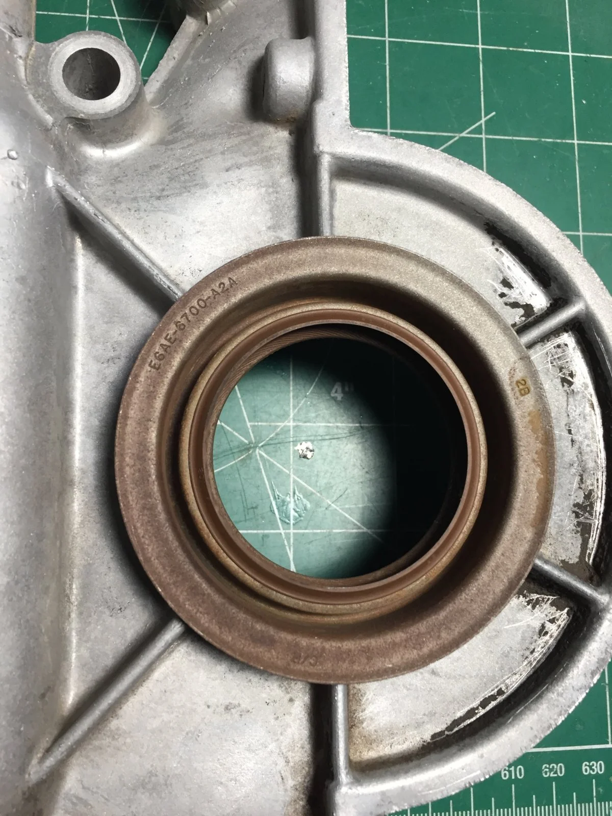

Next up was removing the seal without removing the timing cover. I thought long and hard about doing this and decided it shouldn't be that bad. A seal removal tool pulled it out in just a couple minutes. Really no harder than if the cover was on the bench. I grabbed a new FelPro seal and took my time installing it. The best way I found was a 2 pound small sledge hammer. About a thousand taps later and it was perfect.

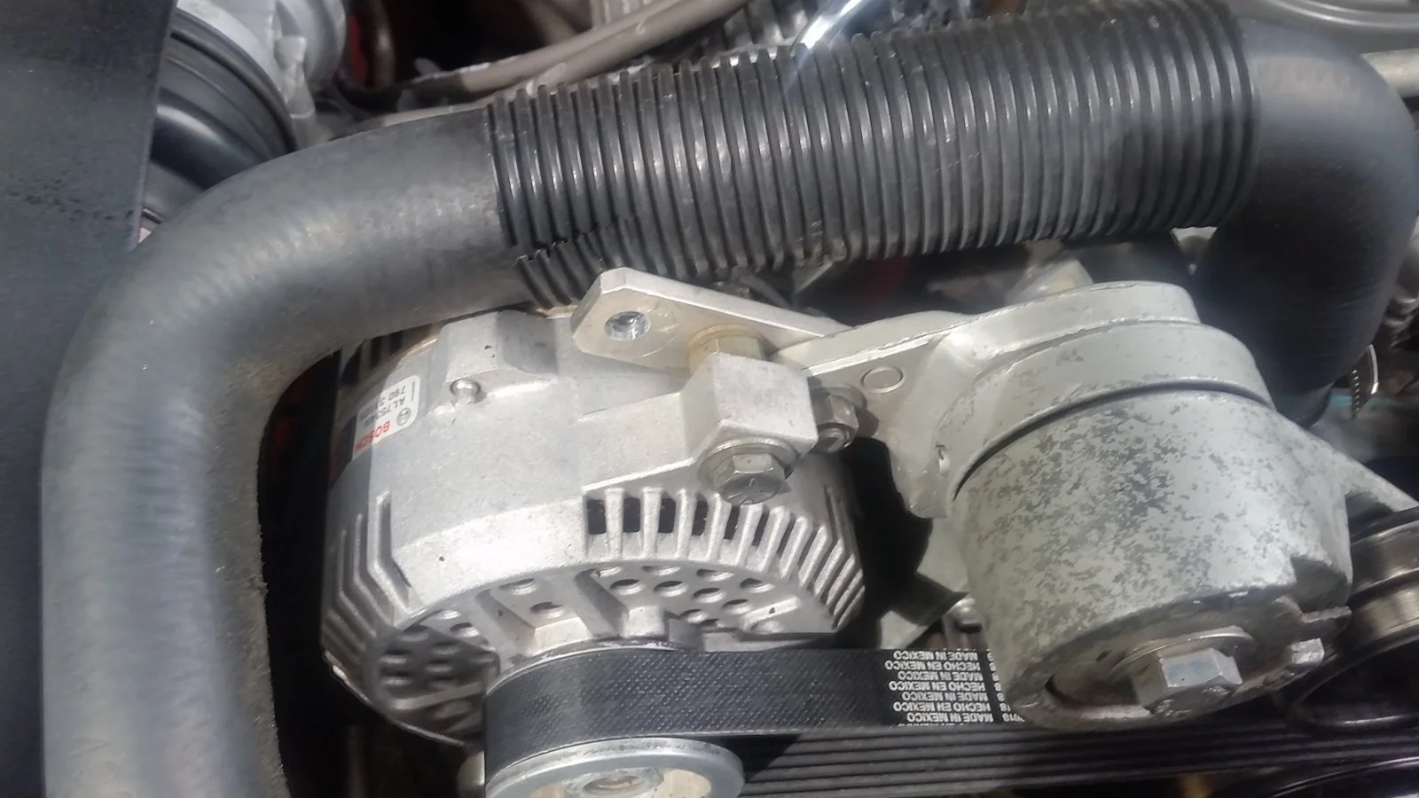

The last thing I had to do was dig thru my old stuff and find the old school "alternator bracket." We used to run these to make the belt work out right when underdrives first came out. I'm sure some of y'all remember them. My new belt was the exact same number as the one that was on the car for the last two years. Apparently it stretched more than the last one because after the short drive home from the carwash, it was about 1/8" from touching (the belt below). So I jacked my alternator out one hole on the bracket and it's good now.
