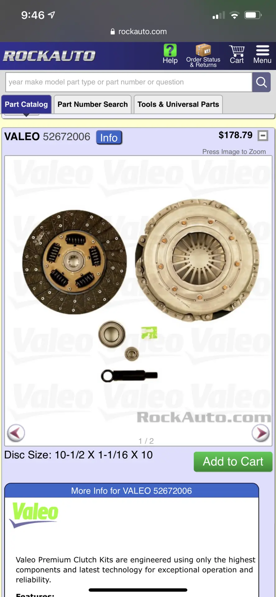

Valeo is a good brand, but my concern with that auction is if they are genuine Valeo parts. I just hopped on Rockauto (usually the cheapest source of parts) and the cheapest Valeo clutch kit is $180. The cheapest Valeo flywheel is $97. That would be $277 for the both of them together.
That link is for a clutch AND flywheel for $180. That makes me wonder if they are genuine.
