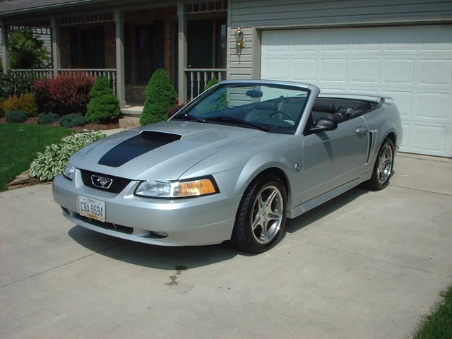

body roll is reduced quite a bit. there is very little nose dive too. i remember the stock suspension was horrible for nose dive. i've taken curves at twice the posted speed limit on several occaisions. the Bullit suspension was the 2nd most noticable mod i did to the car besides the blower. it's firm, but not harsh. and it allows me to get over curbs and railroad crossings without scrapping.

It looks waay better than stock, and that pic just pretty much narrowed it down from a kyb/steeda setup to the Bullitt setup.
Im not looking for my car to sit on its nuts, but for it to look better with small wheelgap and slightly better handling...
BTW is that car an actual LE 35th?
yes it is a real LE 35th.

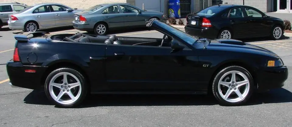

DMBstng do you happen to have a picture from the side??
no, but i'll see if i can get one.
