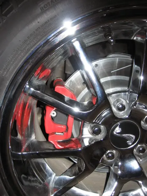

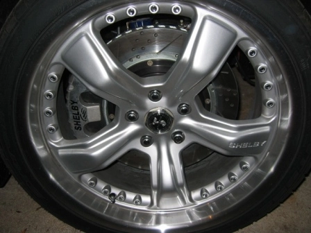

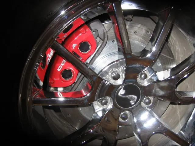

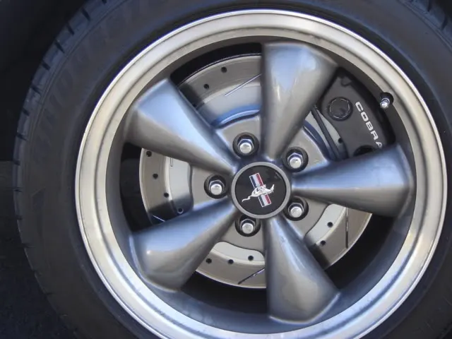

Here you go:
I drilled mine on an Explorer Sport I used to have. It had brakes that were too small to begin with, so they would fade after a few hard stops. After drilling them, the difference in braking performance was very noticable. They would still fade a bit, but it took a lot longer. They did not wear any faster, or wear out pads any faster than before. I drilled them in 2003, and 4 years later, they're still on the vehicle (though I don't own it any more).

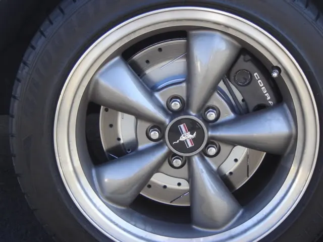

I've got a set to go on my Cobra, but don't have any pics (yet).
Regards,
John.
Looks good.

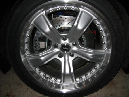

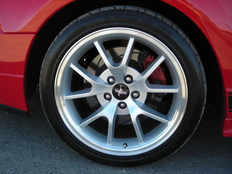

I run SSBC slotted rotors & hawk street pads...They feel better than stock, but honestly I couldnt tell u if it was the pads or the rotors that made it better???
i got them mainly because they look good & I got a great deal on them...
