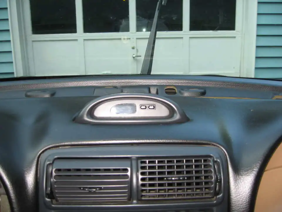

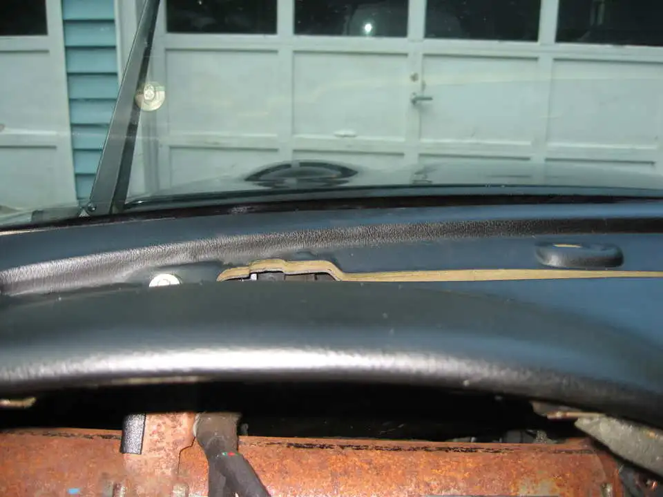

Sorry for the bad pictures. My good camera is not here. Ill try to get some better ones tonight, but you can see the problem even in these.
Sorry about the cell pics, you you can see on the left side of the dash, below the garage handle, that dark dark black line, thats the lower part of the windshield. VS the right side all you see the grey top of the dash. This is taken straight up from the center of the car.
Same height, just a continuation to left of the clock. You can see the line getting bigger and bigger.
Again, sorry for the bads pics. Im trying to get my friend with his nice camera over after work to snap some very clean pictures of it for you. And maybe the whole dash since you can see with the top down while standing behind the car. Thats how bad it is.
Will have much better pics in about an hour and a half. But if you can see the problem here, please let me know. Its driving me insane.
As you can see the picture is taken right in the center of the car and the driver side starts to sag way before it should. Click the picture for full size. I have a couple others, but that one shows it the best

I would try to manualy pull the dash up to the right level and shoot some
expanding foam under it, let the foam set up. Its a 15 year old car so no
big deal if its not perfect. If you want it perfect, get a pro to fix it....
and Im sure that would be about a $1k job. if its low miles and good condition,
would probably be worth it.

thinking about a heat gun and attempting to pull it up a little. I can get my fingers under it and pull up, but then it falls right back down, which makes me think it isnt put in properly, but there is nothing there to support it where its sagging, so I thinking heat gun and pull to see if I can get it up where it needs to be.

I will get you a pick of what it looks like from the back i have dash in the garage i assume some of the mounts bent under extreame heat or cold

That would be great S&B. I was just thinking the same thing. I dont think there are any supports up there, but I was hoping to get a pic from behind to see. Thanks very much!!!
