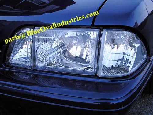

i have HID's on my car. except i don't have the 8k kit, i have a 5k. sooooo bright, i have them aimed almost to the ground and i still have people flashing their brights at me! they look freaking GOOD. i've had them for a couple months but i've been too lazy to take pics at night. i'll get some up soon. i dont have stock lights like in the pic in my sig either, i have these 'euro' lights, looks amazing at night!

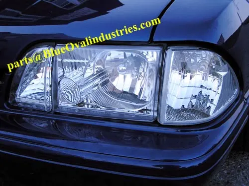

Thanks for the reply. I was looking at the 4300k kit or 6000k kit. Not too interested in the blueish/purple look. I assume that pic wasn't your car being that it was stamped with BlueOvalIndustries.com Any pics on your car.

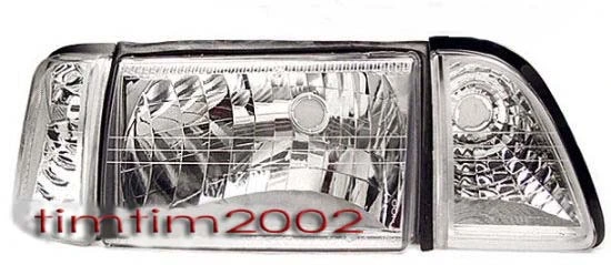

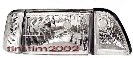

Thats the route i went with.I bought the Silverstar Ulra bulbs and have a new set of Ultra Clear headlights that i still need to install.:rolleyes: I bought these.

yeah that's not my car, but i have those headlights with a plug-n-play HID kit with slim ballasts like 5L5 was saying. and they are the single beam ones, no high beams. you don't need them with these though, they are EXTREMELY bright. No added glare at night either. just gotta make sure you're not blinding people. i've been extremely busy lately with my two jobs, but like i said, i'll try to get some pics up asap.
