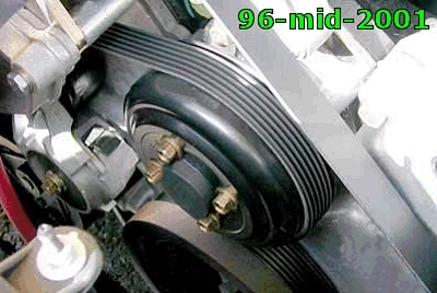

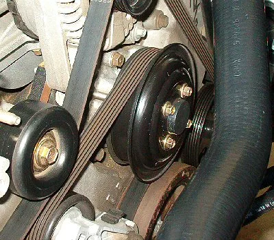

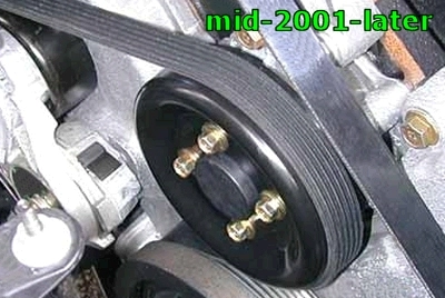

-mid 2001 and on a better water pump pully was used
-check idlers when chaging belt, the idlers are $14 at AutoZone and very easy to change
- http://www.bullittarchive.com/1004.htm
Latest design:
