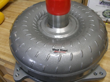

I just purchased an aftermarket torque converter from West Coast Racing Converters. http://www.westcoastconverters.com/
I wrote an article about them if your interested.
http://stangfreak.com/content/index.php?option=com_content&task=view&id=65&Itemid=1
Are you going to spam that junk on every TC thread?
Have you installed that TC yet? :shrug:
StratGT said:
Are you saying the product is bad, or you just venting at the guy. Since we're both in Canada, do you recommend anyone's product here north of the border.
Both, I know that product will not consistently hold a Locked up WOT shift. Here he is again advertising this product that he has but has not even installed it yet.
There are decent TC's out there to get, but I don't know any from our side of the border, they are all in the US.
There are decent TC's out there to get, but I don't know any from our side of the border, they are all in the US.[/QUOTE
I doubt you have anything to back up what you just said.
I watched while they built mine and was assured they are more than capable of holding fully locked at any WOT application. All his custom race converters are built to withstand racing environments.
I suggest you call or e-mail Bill at West Coast Racing Converters.
Rocketman said:
You have his converter, is it installed? Last I heard you don't and you are telling people how great it is. :notnice: How the hell do you know how good it is when you don't even have it installed?
