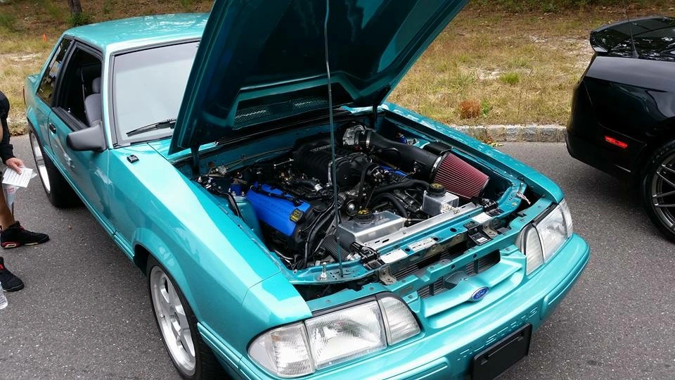

In 2013 I helped do a friends . A year later it got a blower .
AJE K Member .
Bbk swap headers and x pipe
Oem ford bell housing for termi
T56
Control Pack
Florida 50 cluster
Hydratec hydroboost
05 power steering pump was used if I remember correctly it's been a while .
