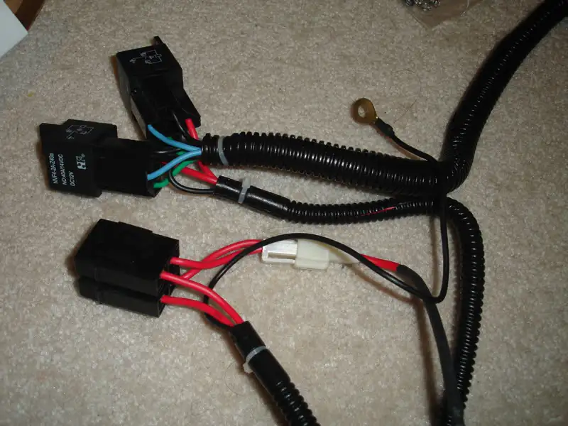

install really is easy. i forgot to time myself like i thought i would, but i could only get through one beer. :shrug: whats that, like 15 min? the beer was still cool sitting outside in 90*. anyway, as for the Ballasts. theyre a pain to find a place to mount. it took me like half the time just trying to figure out where to put them. i mounted the driver side Ballast on the fuse box cover with the double sided tape that came in the kit. the pass side is wedged against the side of the engine compartment, next to my intake tube. i couldnt easily get the tape on the back of the one, so i used like 3 zip ties from different angles to secure it in place. theres a ton of wiring too. most of it i zip tied together and stuffed it down next to the battery, in the smal open space between the engine, battery, and radiator. the wire that i had to run to the pass side bulb i ran on top to the radiator, but under the shroud. if you look close, it might be deemed as "ghetto". when i get some free time at work i might mess with it some more to try to hide everything better.

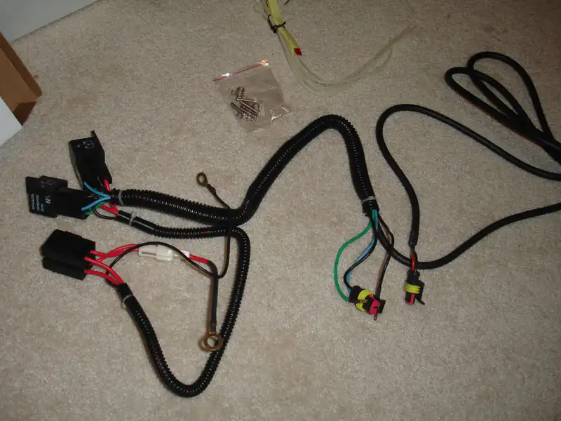

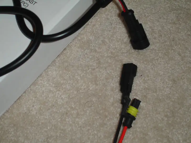

Boxes the kit came in
Ballast itself
Connectors on the ballast

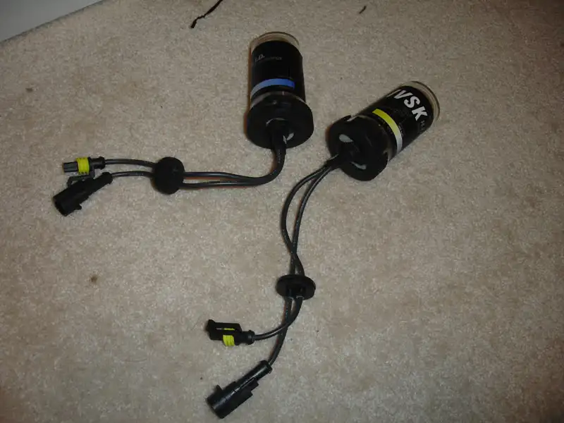

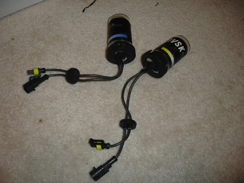

2 bulbs
the connectors on the bulbs

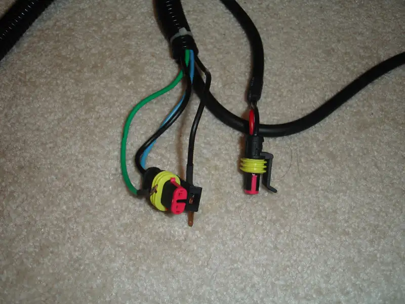

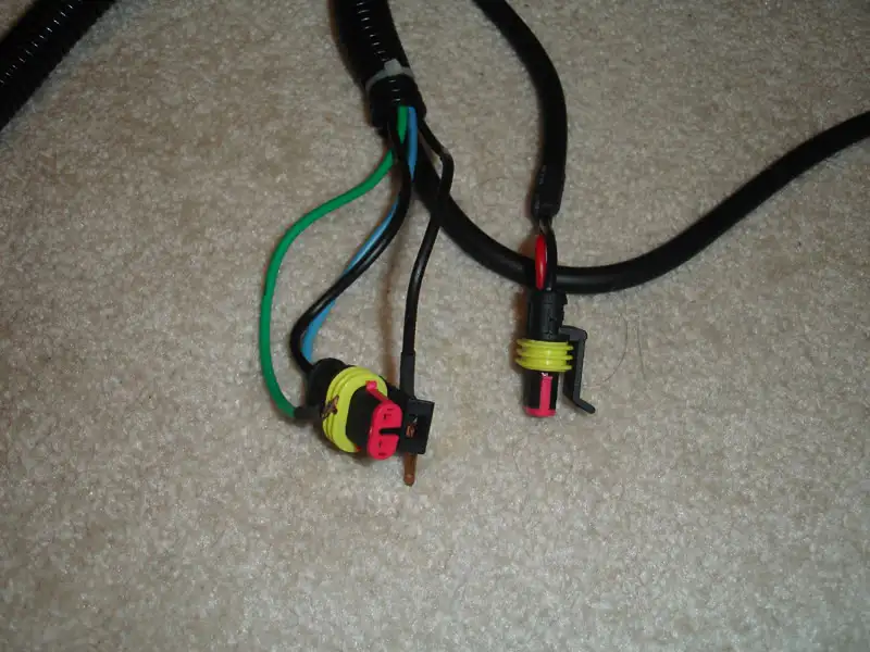

The wires
1 end
other end
That is all. I got home too late to install them :(.

san~man said:
Looks like pubes on the rug :barf: :jester:
heh-heh......heh.....heh-heh-heh.....he just said "pubes"....heh-heh....heh-heh-heh

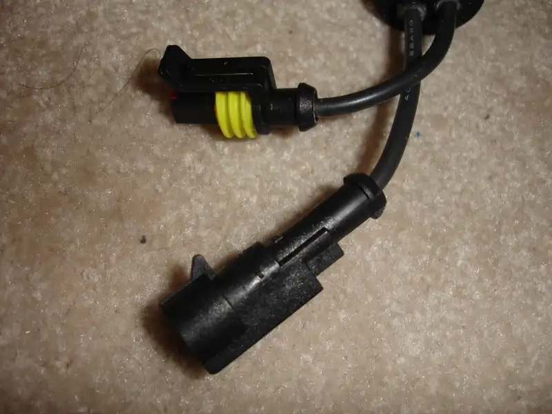

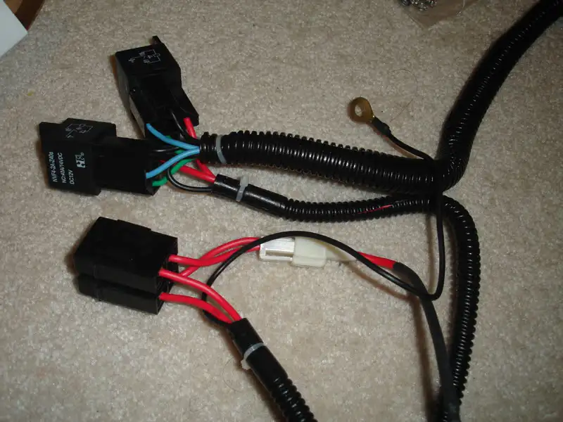

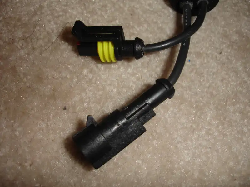

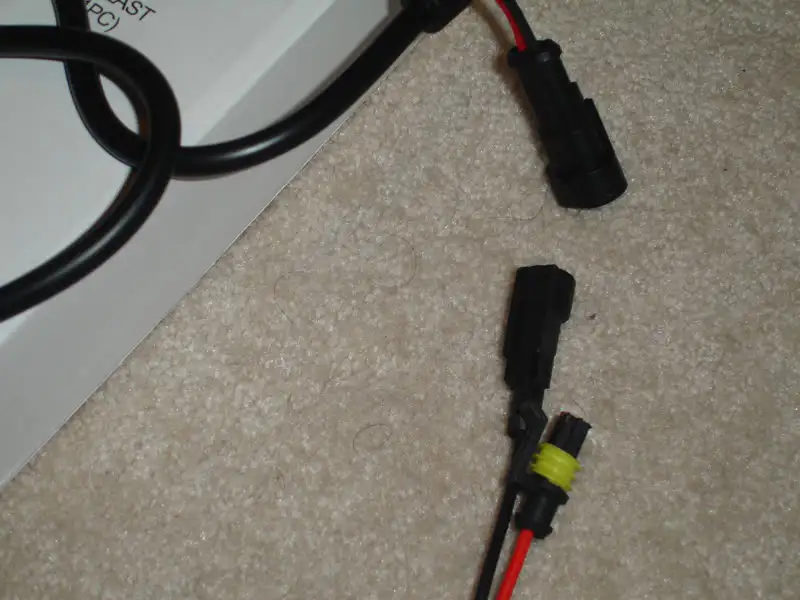

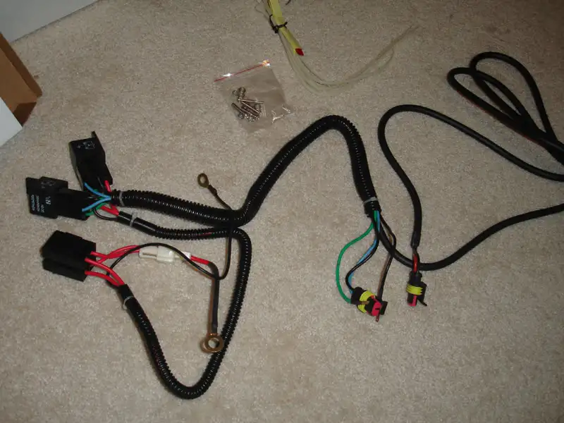

From the pics, the wiring harness and relays look to be of good quality, similar to that supplied with McCulloch kits. What sort of kit connector, if any, is used to connect to the stock headlight bulb connector? It looks like two exposed pins from the pic.
You probably insert them into the the headlight bulb connector on your stock wiring harness. I bought a HID fog light kit that came that way and was not impressed that an actual connector had not been used. I used the base of the OEM fog light bulbs and soldered those spade pins you show in your close-up pic to them to make a secure, watertight connection. You could use the base of a OEM headlight bulb in the same manner if need be.
