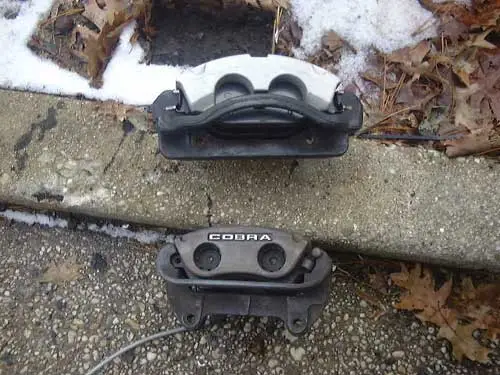

here is a pic showing that the +99 GT/V6 caliper is in fact larger then the cobra/bullit caliper:
One has to remember that the +99 GT/V6 Caliper is a newer design then the cobra caliper which was introduced in 1994. They are both made by PBR.
