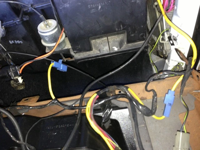

I took my dash out to replace the heater core and do a color change. I took too long putting it back in and can't find where one of the two yellow wires plugs in. They are the yellow ones with the blue plug. My car is an 86 gt convertible.

Just in case anyone else runs into this... The one wire was for my convertible top. That is the one I hooked up. The other went to a plug that wasn't plugged into anything. I am assuming this is the rear defrost plug. Since a convertible doesn't have rear defrost it makes sense as to why that plug went to nowhere. It also explains why a convertible has 2 of those wires as opposed to one that exists in a coop or hatch car.
