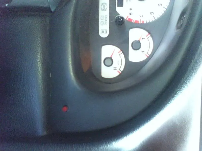

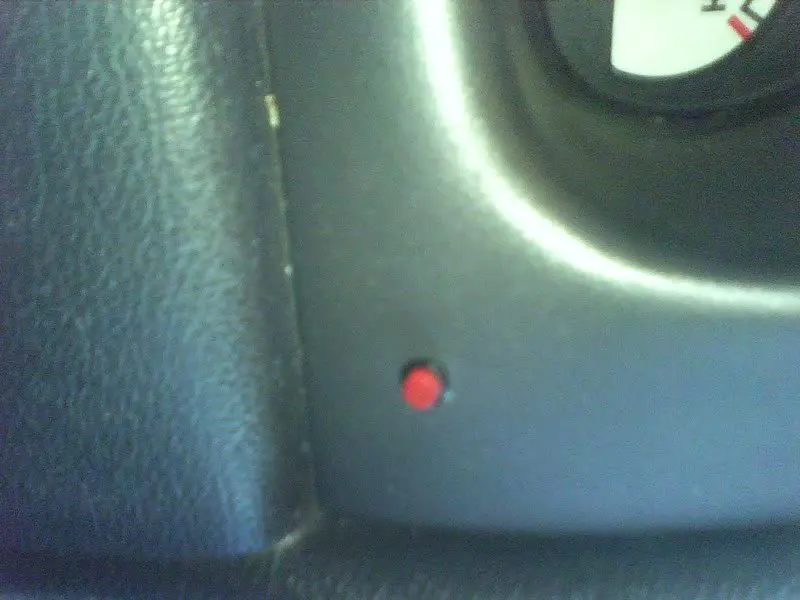

i've been wondering what the hell this little do-hicky is embedded in my dash next to my gauges. it looks like a light of some sort, its definitely not a button. any ideas?
sorry for the crappy res, its from my phone :D

lol i wish it was some type of cool button with hidden nos. no it doesnt light up at all, the car came with an aftermarket alarm that someone seems to have "manually" disabled, but the light for that is a cool blue strip on the a-pillar. other than that the car came with two suspicious drill holes on top of the dash and to the right of the gauges, those holes probably belonged to a tach or something. as for the little red light, im clueless. i havent seen any other car with one so im stumped.

my GF's accord coup has one that says clifford around it. Red, kinda clear, not a button and does blink - same deal.
That is the light alarms come with, looks like an Ungo or Audiovox. It may have been disconnected in favor of the upgraded light, but thats what it is for is an aftermarket alarm.
lasersvt - i guess ill just leave the little light there in order to avoid a hole in the dash :p the other light they put in is a**loads sexier, its like a clear flame pod that does the whole knightrider light sequence in blue. alarm dont work for ****, but you can see the lights from 30-40 feet away so it makes people nervous lol
