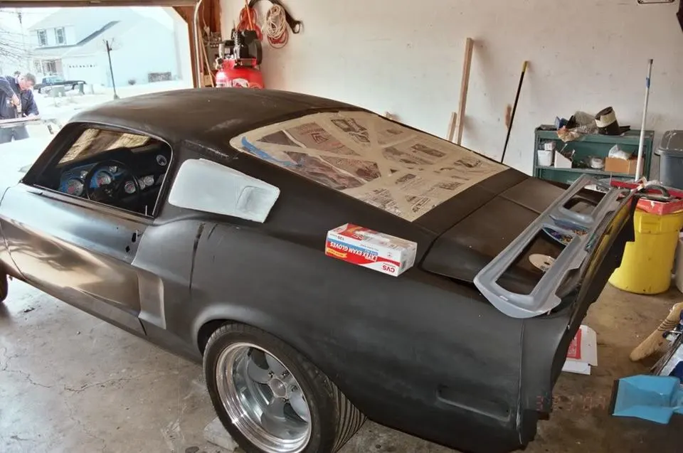

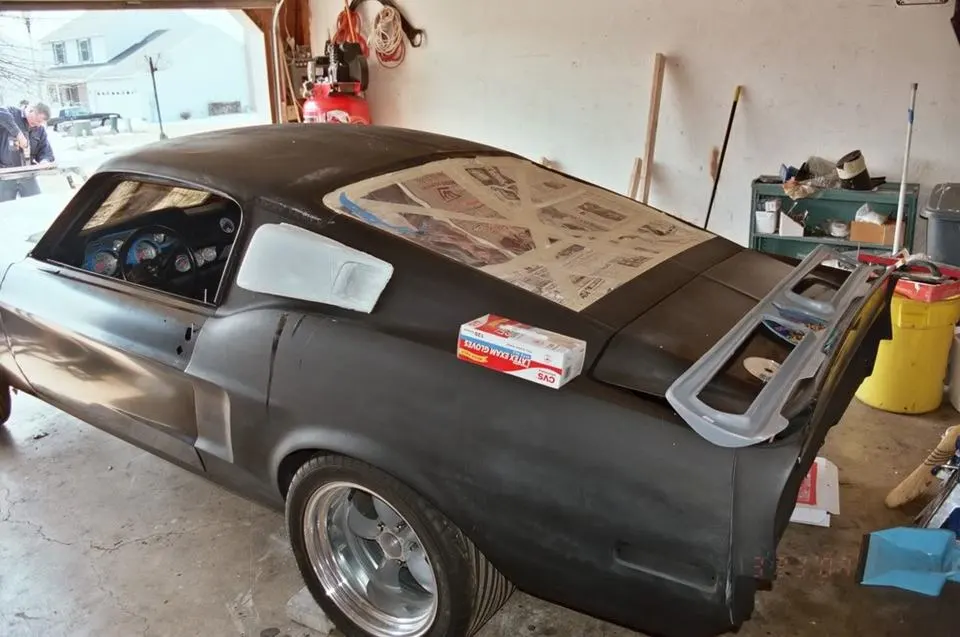

On the wife's 68 fastback we moved the inner wheeltub in approximately 3/4"in the back and about 1 1/2" in front, effectively "squaring" the wheelhouse with the frame rail. This made the wheelhouse pretty much even with the side of the leaf spring from front to back. By only moving the wheel house in 3/4" we are still able to use the original interior panels without modifications (the fold down seat latches have to be moved in to match up). On the 68, a set of 295/50 X 15 on 10" rims fit with no problem, but there would be interference with the leaf springs. We are looking at probably the TCP G-link, or possibly the EVM 3-link for rear suspension. Even with these clearances look like they will be tight.

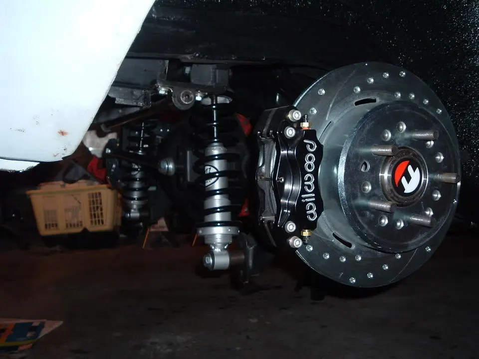

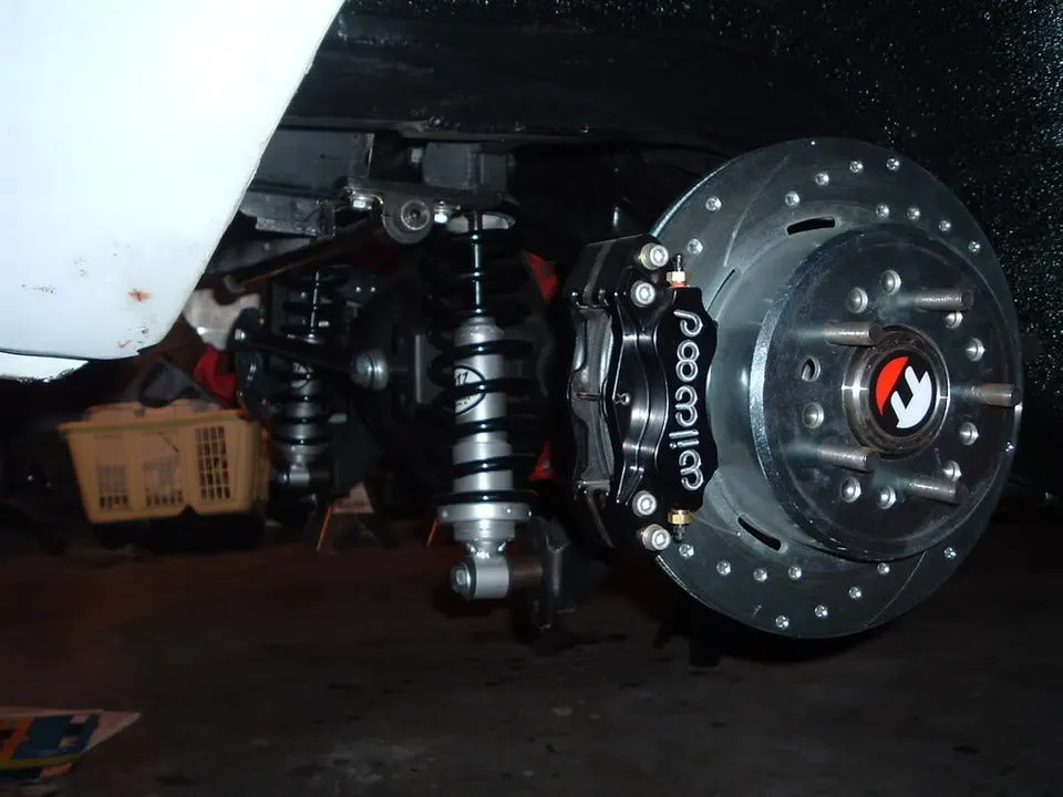

I am eventually putting rear disc brakes on the car which will push the wheel out another .25"

The rim shown in the pics is physically 12" wide, but bead to bead on the inside is 11". The tire I am getting has a max section width of 12.4" so .2" on either side of the rim.
Worst case scenario, I can push the wheel out another 1.25" I'd rather keep it as tight to the leaf springs as I can get away with, without rubbing.

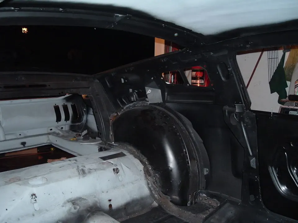

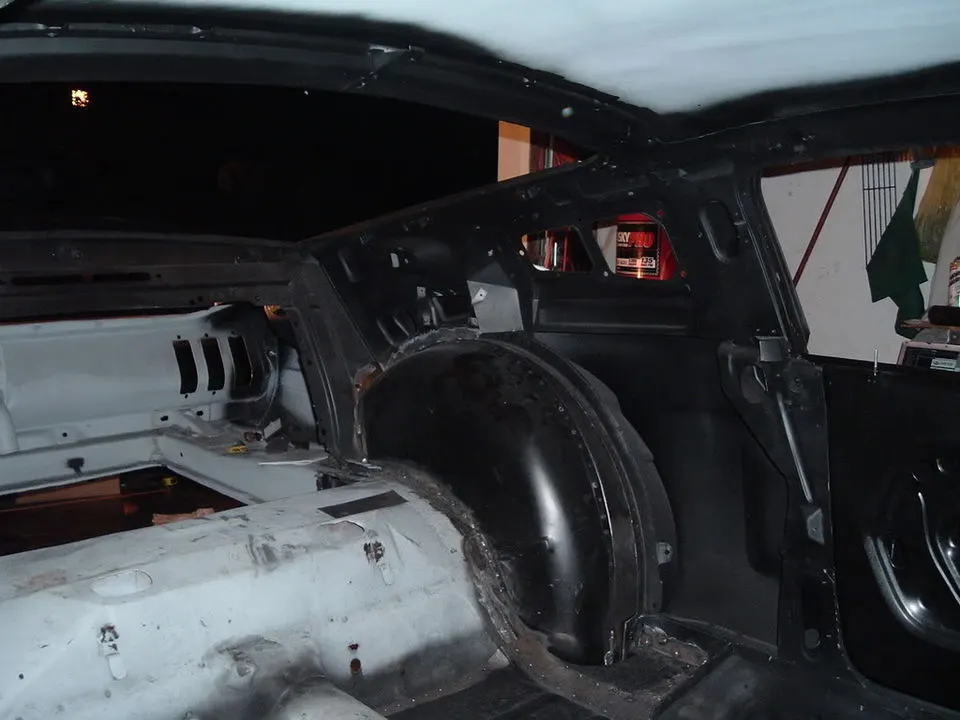

I mini tubbed mine, I took it all the way to the frame rail. Though I am no longer running leaf springs, and i narrowed the Rear.
This is from inside though not yet complete.
Those are 315's I have plenty of room and the tuck nicely, though i went a bit over board. I know 12 sec goal got his to fit with some miner modifications.

I had the interior in the car with the cage, and the tub done. As you can see there is no inner fender bracketry. With the Mini tubs in so far the interior FB panels pretty much rest right up against the inner fender.
