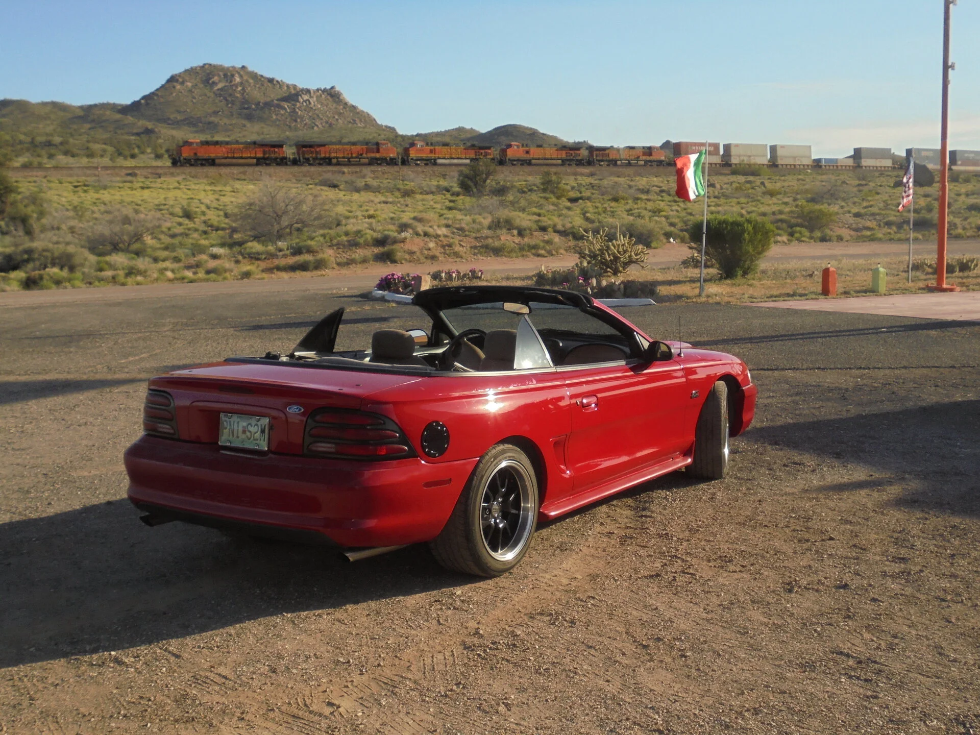

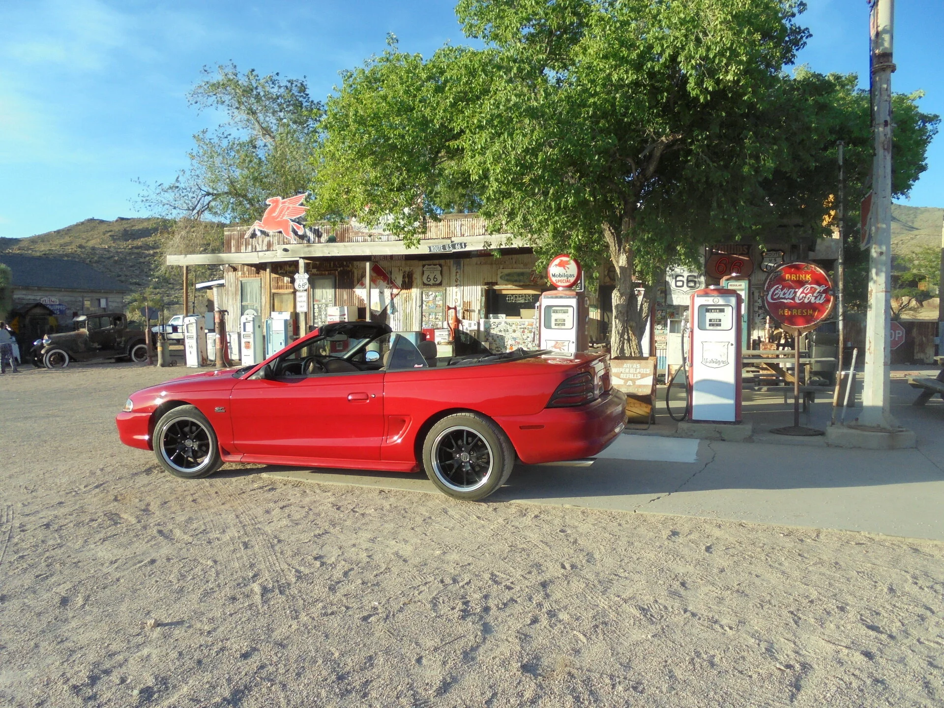

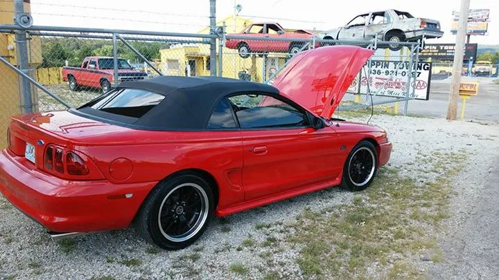

Very nice, I'm on the look out for a Fox body if the price is right. I have a set of P heads and GT40 intake saved in my shed just in case I find a cheapy out here. This is my car now. Much more tame then my old 94 coupe but she's a good cruiser. First pic is when I picked her up in southern Missouri. It sat a little lower then and had the vertical tail lights on it. The 2nd and 3rd pics are in AZ and before I ripped the back interior out and repaired the 2 rear window motors.
