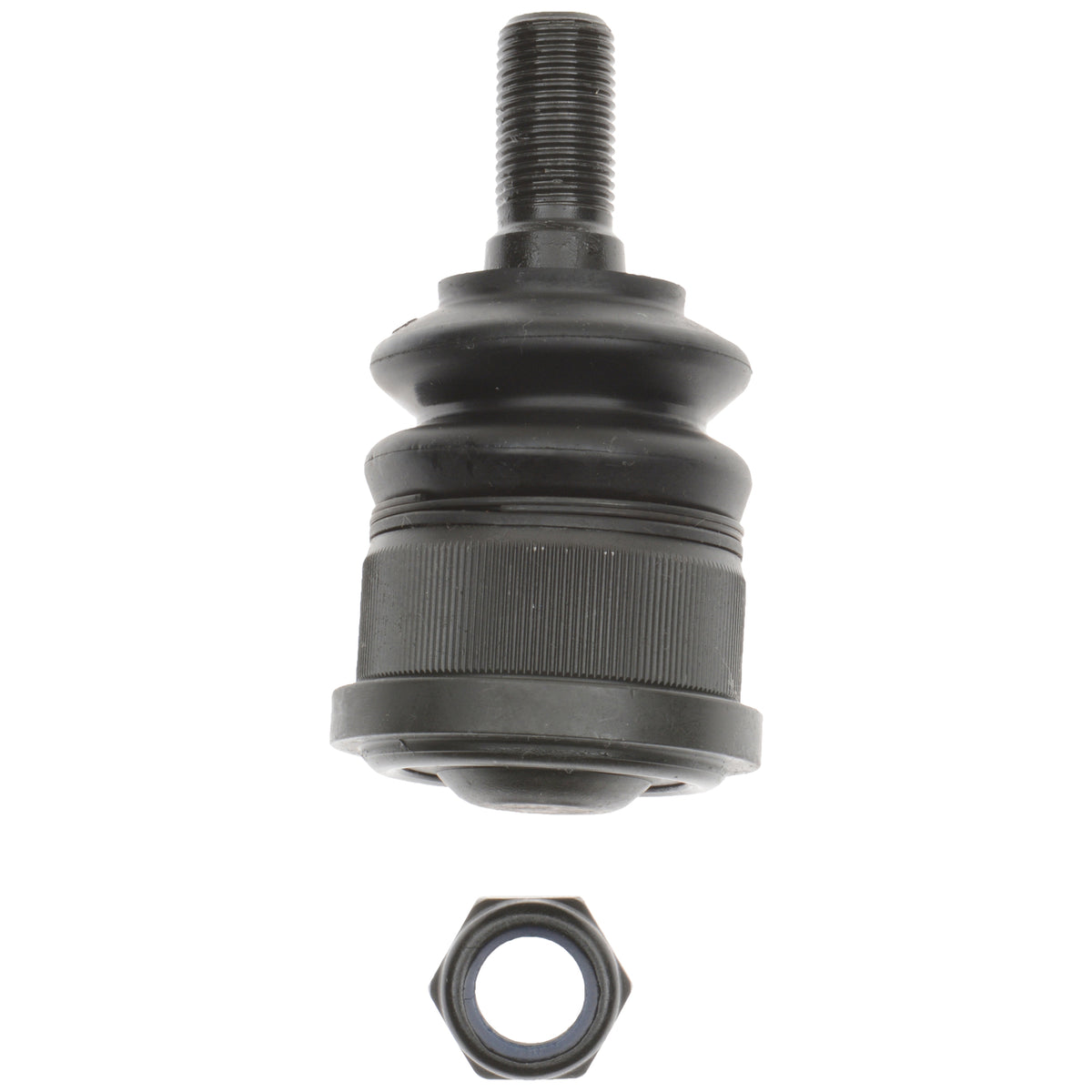

Front Lower Ball Joint for Ford Mustang 1979 - 1993 TRW JBJ869
TRW JBJ869 Front Lower Ball Joint for Ford Aerostar: 1986 - 1997, Ford Country Squire: 1987 - 1991, Ford Crown Victoria: 1992 - 1994, Ford Fairmont: 1978 - 1983, Ford Granada: 1981 - 1982, Ford LTD: 1979 - 1986, Ford LTD Crown Victoria: 1987 - 1991, Ford Mustang: 1979 - 1993, Ford Thunderbird...

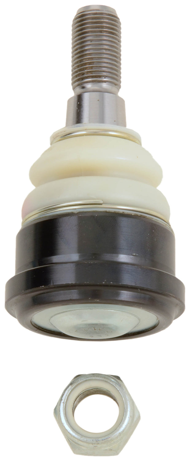

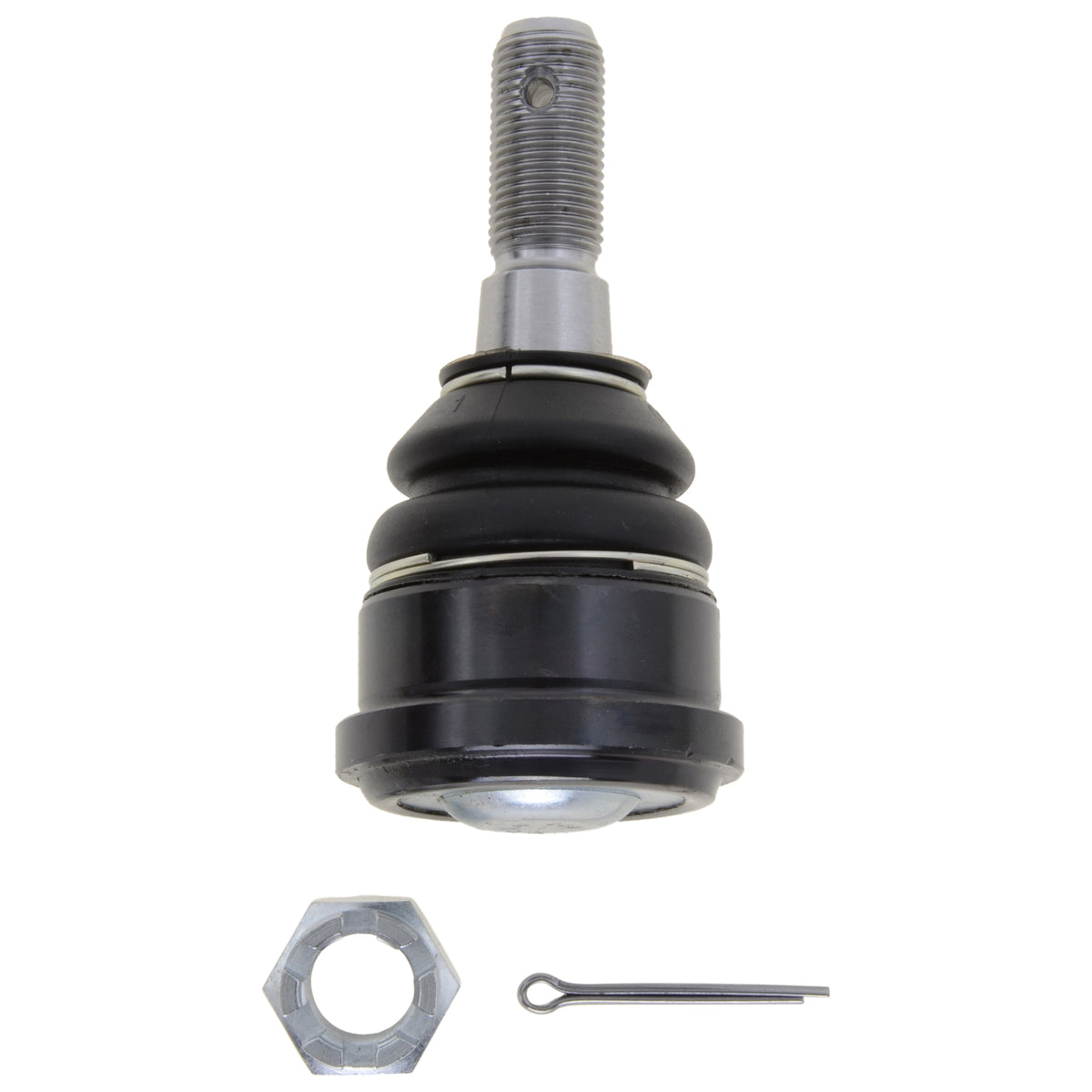

Front Lower, Front Ball Joint for Ford Mustang 1994 - 2004 TRW JBJ1174
TRW JBJ1174 Front Lower, Front Ball Joint for Ford Crown Victoria: 1995 - 2002, Ford Mustang: 1994 - 2004, Lincoln Town Car: 1995 - 2002, Mercury Grand Marquis: 1995 - 2002Our state-of-the-art ball joint program includes the latest low-friction design technology, giving you reliable and robust...
trwaftermarket.us
Front Lower, Front Ball Joint for Ford Mustang 1994 - 2004 TRW JBJ875
TRW JBJ875 Front Lower, Front Ball Joint for Ford Crown Victoria: 1995 - 2002, Ford Mustang: 1994 - 2004, Lincoln Town Car: 1995 - 2002, Mercury Grand Marquis: 1995 - 2002Our state-of-the-art ball joint program includes the latest low-friction design technology, giving you reliable and robust...
trwaftermarket.us
Why is there a different ball joint for GT and Cobra? Don't they have the same spindle?

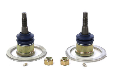

The SN95 ball joints are shorter. If you use Fox ball joints with an SN95 spindle you need a 0.330" spacer between the top of the spindle and the castle nut so it will line up and you can get a cotter pin through the hole.
So yes, if you are going the the SN95 style spindles and changing ball joints then go with the SN95 ball joint. If you want a really good one then go with the low friction design like Maximum Motorsports sells:
Low-Friction Ball Joint, 1979-2004 Mustang
If you have deep pockets and want to "improve" the suspension geometry then the Steeda X2's are supposed to be really good:
Steeda Mustang X2 Ball Joints (1994-2004/1979-1993 w/ SN95 Knuckle)
Steedas X2 greasable ball joints are a longer, stronger ball joint designed to raise the front roll center of your 94-04 S197 and 79-93 fox body Ford Mustang, which becomes lower as a result of lowering the suspension. The X2 ball joint will improve han
www.steeda.com
So $90 for the MM units ($45 ea) or $170 for the Steeda units (sold as a set).

I need to replace my drivers side balljoint. I mistakenly bought a fox MOOG balljoint not knowing i needed a 94+ one. Since i'm lowered, those Steeda ones look like a good option. Do you need a bumpsteer kit (like MM's) with the steeda balljoints? Their website says it corrects the geometry so just wondering if you need both or if just those x2 balljoints would be enough.

If you go that route I would just put it together and get the car on the ground and drive it to settle the suspension in. For a street car my rule of thumb is to make the tie-rods parallel to the control arm. You can get offset power steering rack bushings if you need a little moment and if that won’t get it where it needs to be then MM’s tapered bump steer kit will more than likely get it where it needs to be.
I ran the low friction Motorcraft ball joints with MM’s tapered bump steer kit on my Coupe for a couple years with zero issues. All that came off when the tubular k-member got installed.
