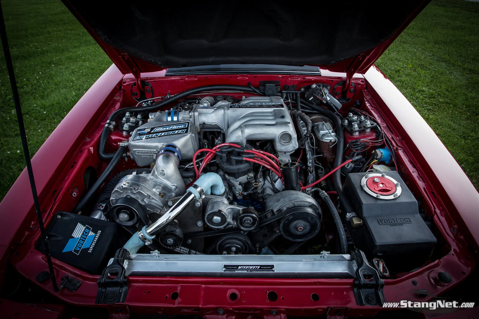

I'm running a 347 with a V3 and charge cooler, it puts 510 to the wheels on 91 and it's a lot fun. Do it!
347 Stroker w/Vortech V3

Here's a few, the only thing that's changed on the car since the images is headlights, they're now dark.
1988 Notch
  • Media owner IcoLove
  • Date added Jun 16, 2015
1988 Notch
