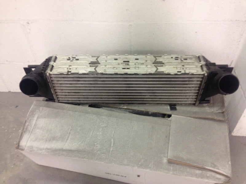

@84Ttop
i have this intercooler from a 2015 bmw....thinks its worth installing?

i should just stick to the plan never mind...lol
