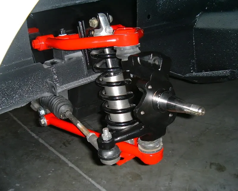

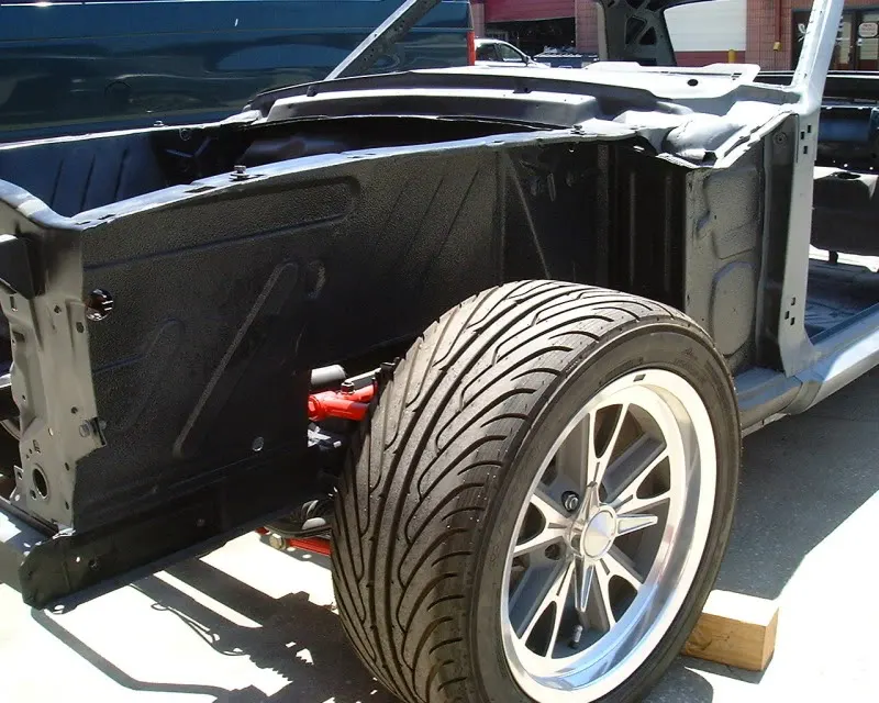

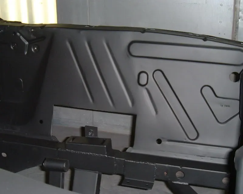

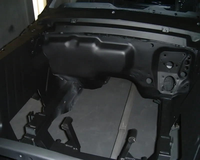

I have had an FE since 1966 and The best ET for my Mustang is 10.75. The only thing I don't like about an FE in a Mustang is the shock towers and installing headers. On my 68 Coupe street car I went with a Rod & Custom front end to do away with the shock towers.

Could you provide me a pic of that front end? I have been looking into front end to do away with the shock towers. Are you happy with it? How does it handle? I bought only a shell, so I taking it apart and building the suspension, I want to get as much power to the ground as I can.

How hard was it to instal? Looks GREAT, I looked at their website the other day. I think pricing was about $22-2500

The hardest part is removing the shock towers.

Everything is different when installing an FE motor. You don't have to remove the shock towers but they do get in the way especially if running headers. You will also have to run a beefed up 9" rear with at least 31 spline axles and some kind of traction control devices on the rear.
