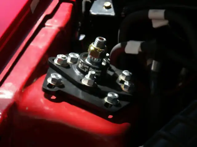

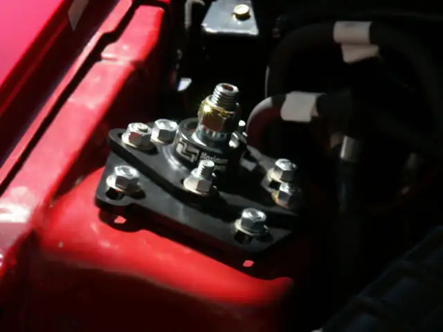

You use them both above and below the strut tower. The lower ones go between the strut and the underside of the strut tower. This determines how far the strut shaft will extend into the engine bay.
The upper ones are to make up for the lengthy shaft between the top of the strut tower and the strut mounting nut.
What ever combination of spacers you use, they have to be identical on both sides of the car.
See the spacer below the nut?
Strut Shaft Spacer Kit, Caster Camber Plates [MMCCSpacer] : Maximum Motorsports, the Latemodel Mustang Performance Suspension Leader!
