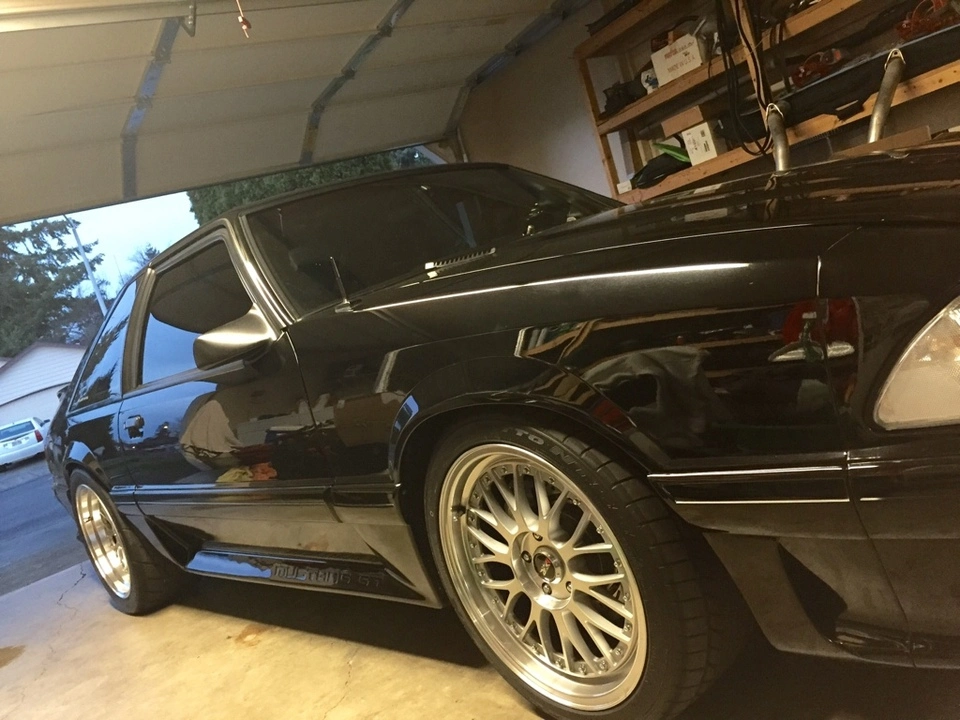

Oh I see. For an 8" wheel, I'd say you'd want around a +12 to +15 offset. For reference, this is my car with an 8.5" wheel in front with a +25 offset.

Those do look pretty good,
But those are also 5 lug, there are plenty of 5 lug wheels that fit a fox correctly, not so much for 4 lug.
