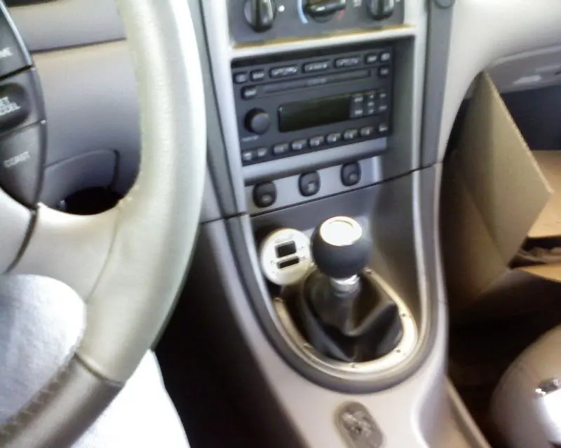

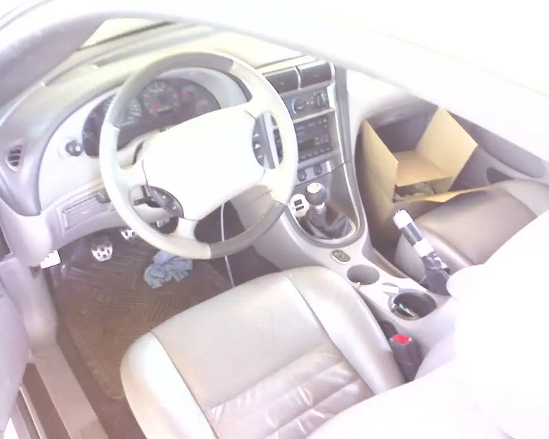

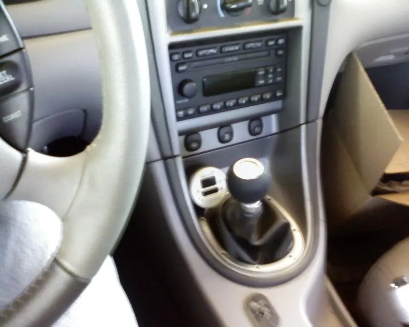

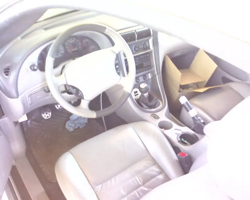

Its a tuner switch for my new cobra's tunes. It has 3 settings: 0, 1 and 2. And it looks like it goes down into my ECU.... But at the same time it also looks like its a phone jack and could plug into a laptop. It is currently set to 1. Supposedly thats the cobra's tune. 0 is stock and "2" is for 100+ Octane. So it stays on 1.
The kid that sold me the car said its from SCT (he didn't install it in the car though, it was there when HE bought the car too). So I dont know much about this. Anyone seen this before? Or know what it is?
I was never given, nor saw any dyno sheets for this cobra when I bought it. It drives like a champ and feels like its tuned...but i'll be dyno tuning it in a month anyway before I really open the car up on the road and track.
Now.....Can a tuner plug this into their laptop to tune my car, by chance? Or will I still need to bring an SCT X-Cal2 when I want a dyno tune? Anyone know anything about this??
LOL he just left it like that? Mine is an SCT 4 bank (0,1,2,3) but its the same thing. Its SUPPOSED to be installed like this. Very bottom of the pic you can see it. I believe I got the cover over on MD.
And no I dont think you can link into it. I know tim just pulled the chip that the wire attaches to out of the EEC and reflashed it. You cant use a X cal with it unless you pull the ship I believe....or run it on the "stock" setting. The X cal flashes the factory tune...the chip just manipulates the stock signal/settings into whatever you want to happen. I love mine.

Ok so If I buy an SCT X-Cal 2.....the tuner will dyno tune the car with the Xcal? What happens with his little switch then? Do I have to uninstall it or someting?
I just want to know what the hell do I do with this thing when I want to get the car tuned...never seen anything like this before
Yep, no need for an X cal at all. It will drive up the cost ALOT for a tune. I got mine dyno tuned by Tim for $450. They gave me like $125 off for having the chip already.
