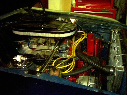

This is an AFCO in a '69 from this thread.
attachment.php
