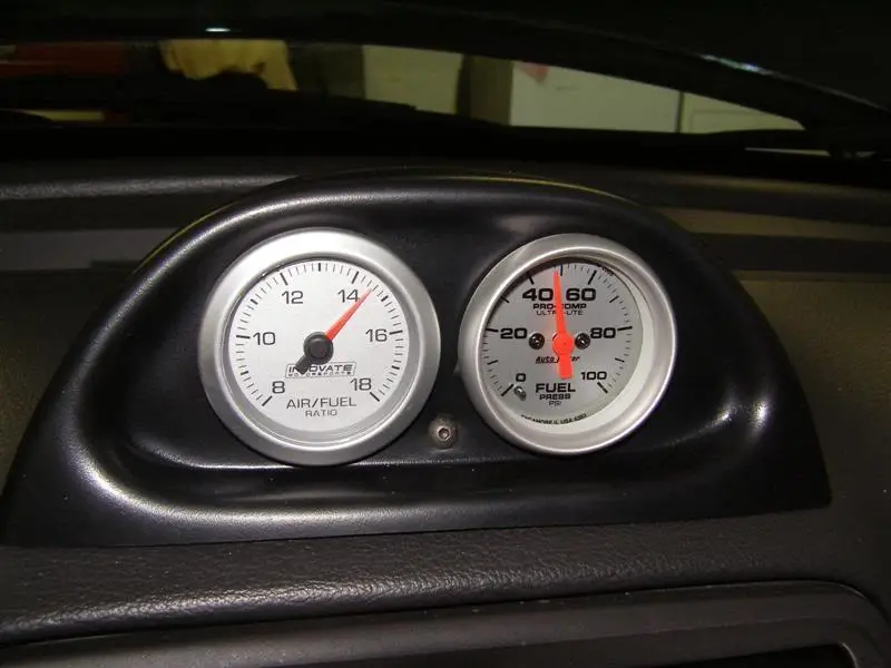

Narrow band set ups are good for nothing but show. You need a true Wide Band kit to "accurately" monitor your A/F ratio. You might as well hang a digital watch from your rear view mirror....you'd get more realistic results. I'd suggest the Innovate Motorsporst LC-1 kit if you're trying to do it on a budget.
http://www.innovatemotorsports.com/products/lc1.php
It's inexpensive (as far as Wide Band kits go) and dead on balls accurate. I bought one for my set up, but I have yet to install it.

The AutoMeter A/F ratio gauge is intended only for narrow-band sensors (0-1.5V output). The AutoMeter A/F ratio gauge is little more than a psychadelic light show, and doesn't represent any realistic a/f ratios because of the way the PCM/EEC controls the fuel trims in closed loop. If you really want to monitor the a/f with gauge, you need to look into a wide band setup.
A wide-band has a 0-5V output range, although many wideband controllers allow you to emulate the narrow-band signal, so you could connect it. Most wide bands are complete kits that include a sensor, a controller to heat and calibrate the sensor, and a digital readout. For example, the Innovate LM1 is a portable unit, with an integral LCD readout of A/F ratio. But they also make the LC1, which is a fixed mount controller that drives a separate dash mountable analog or digital gauge. Altronics makes a dual channel controller, with audible alarms. There are a bunch of wide-band alternatives available.
