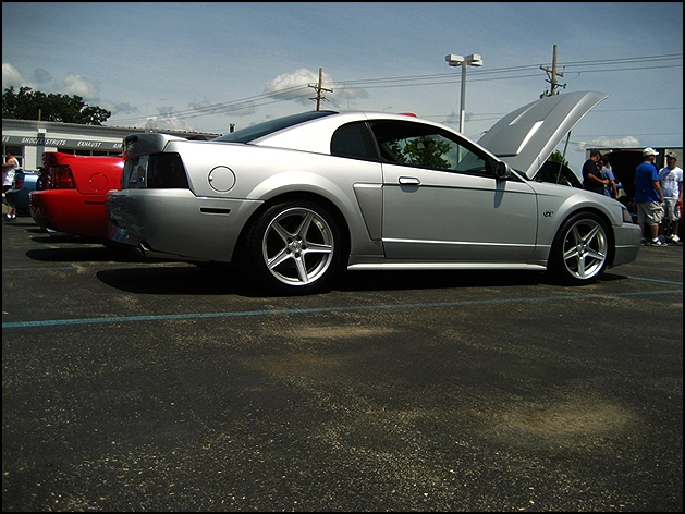

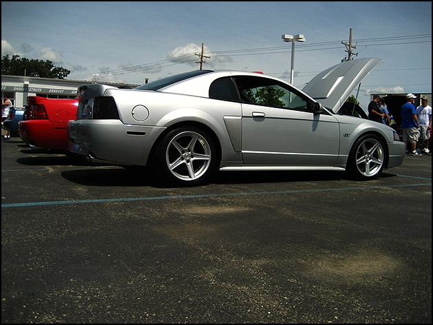

Removing the Iso's on a stock ride height car won't do much. Your best bet is to cut your springs as posted above. A lot of people knock going this route, but I haven't had any problems. I use to have H&R Sport lowering springs, but I changed up my entire suspension setup front and back and ended up cutting my stock GT springs up front. I'll probably be going with some MM Coilovers in the future, but for now the cut springs work out pretty well!
Here's a pic of my car with the front springs cut just under a coil and a half - with NO iso's:
I have Kenny Brown springs in the rear with my IRS, and Bilstein struts, Cobra Control Arms, and MM CC plates up front to compliment the drop.
