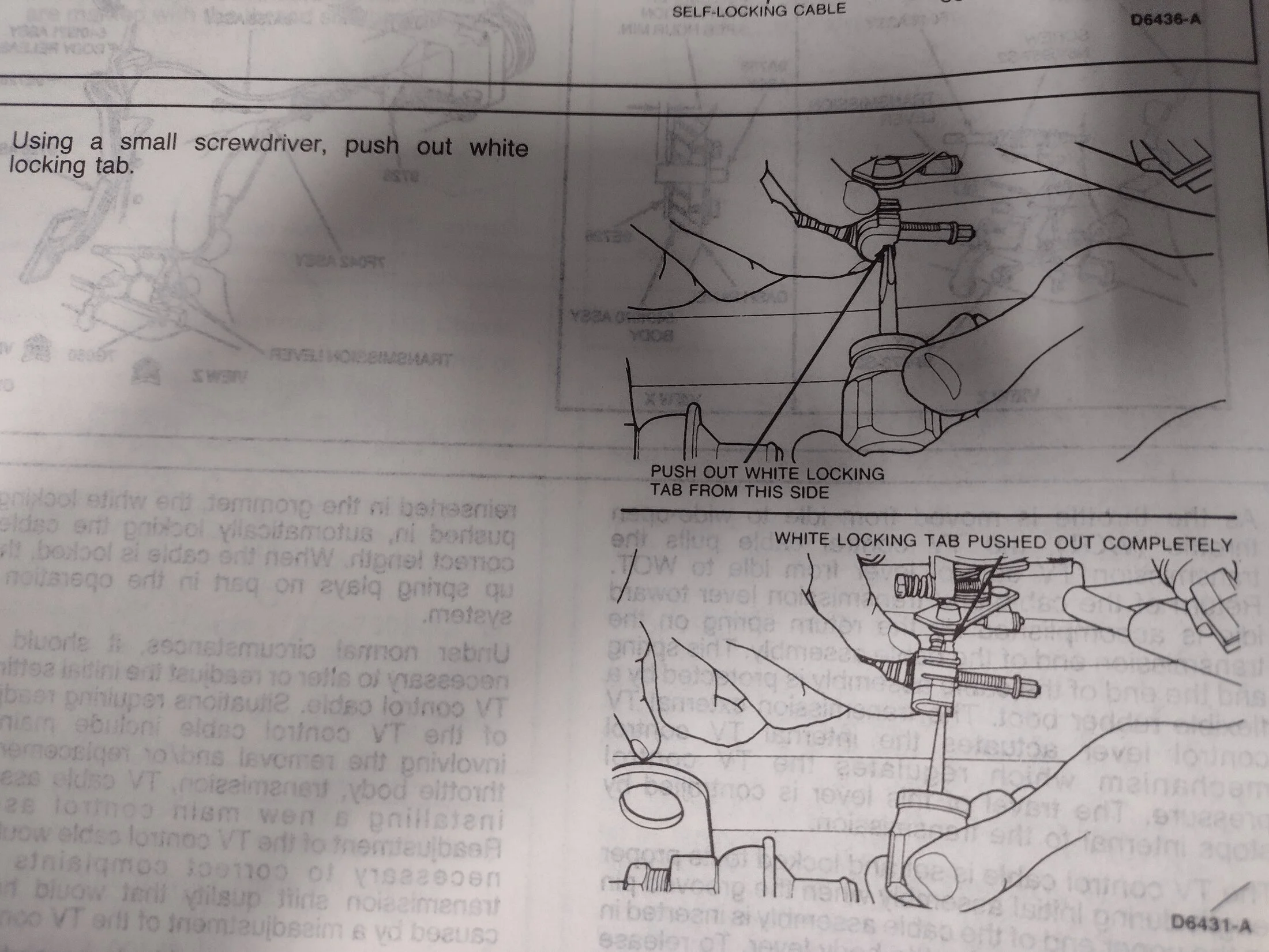

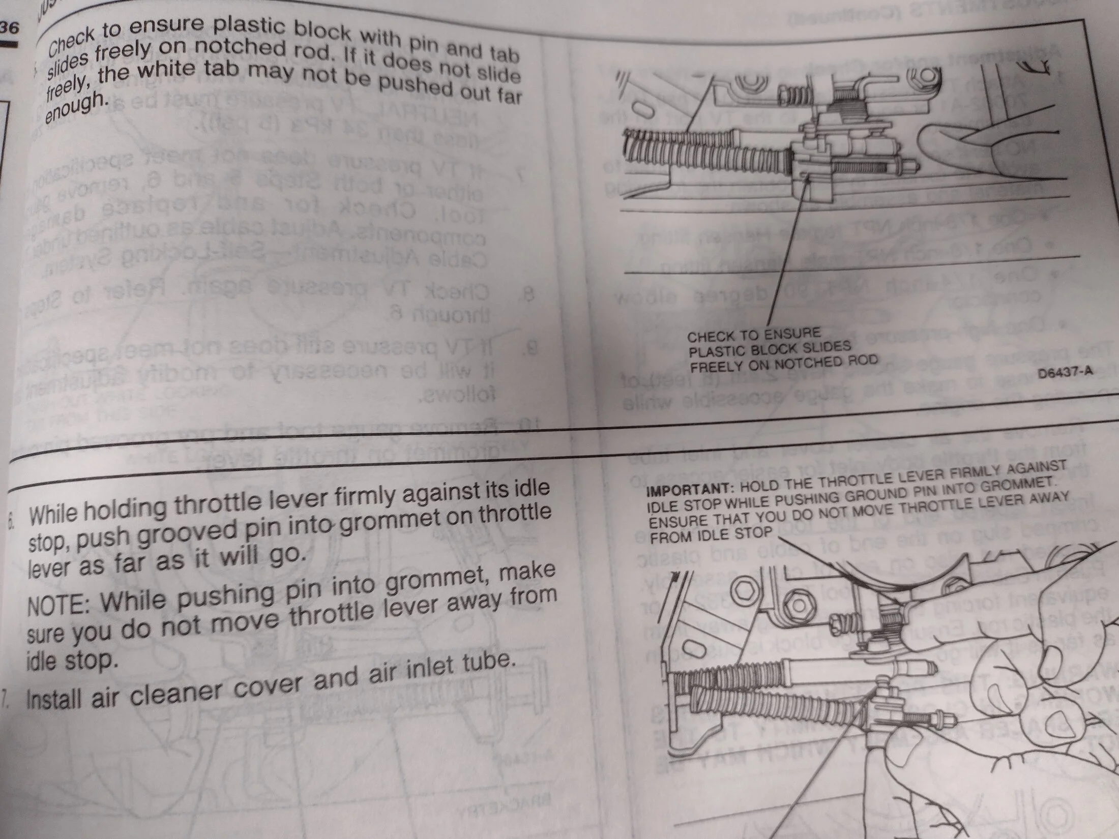

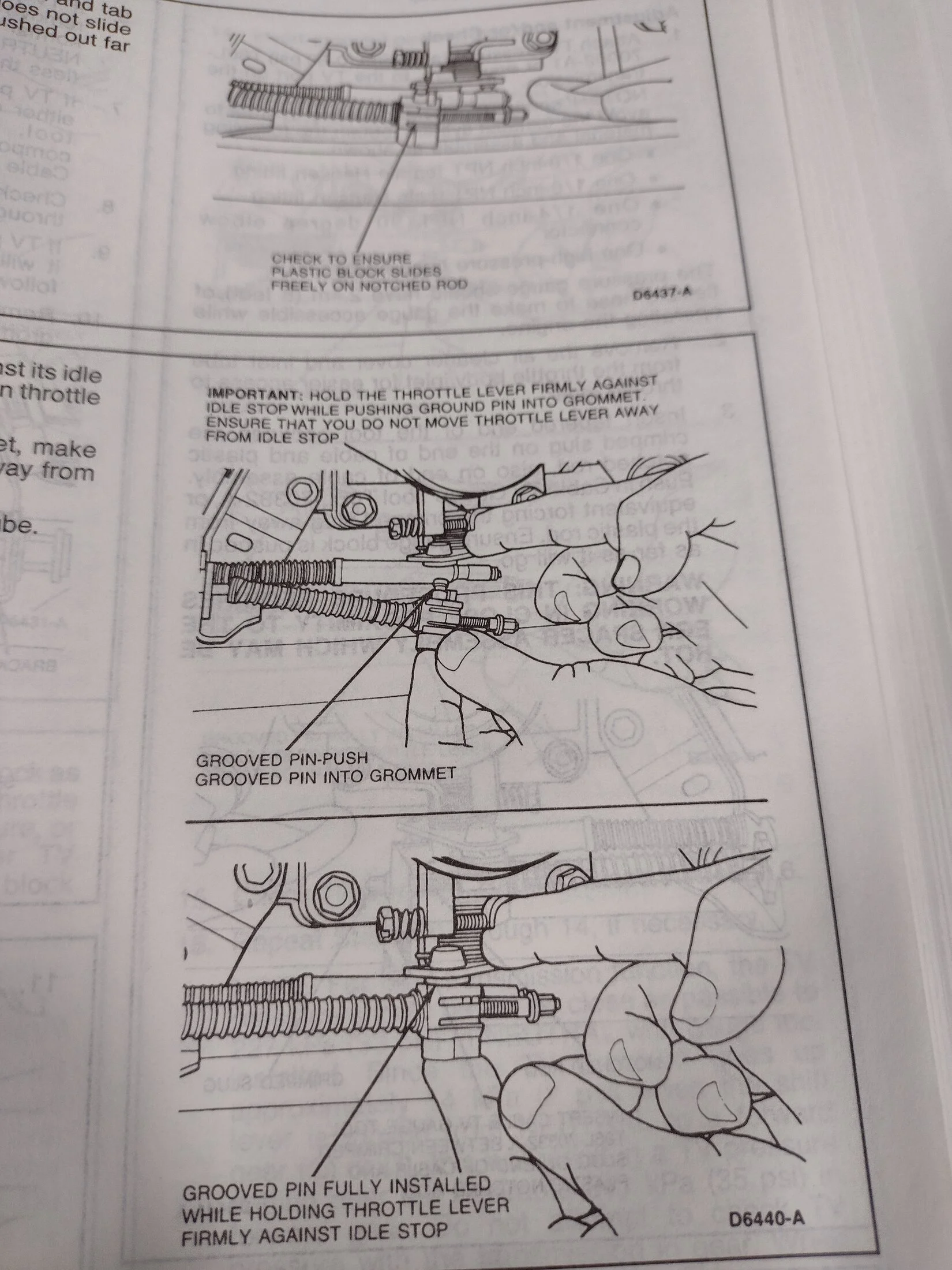

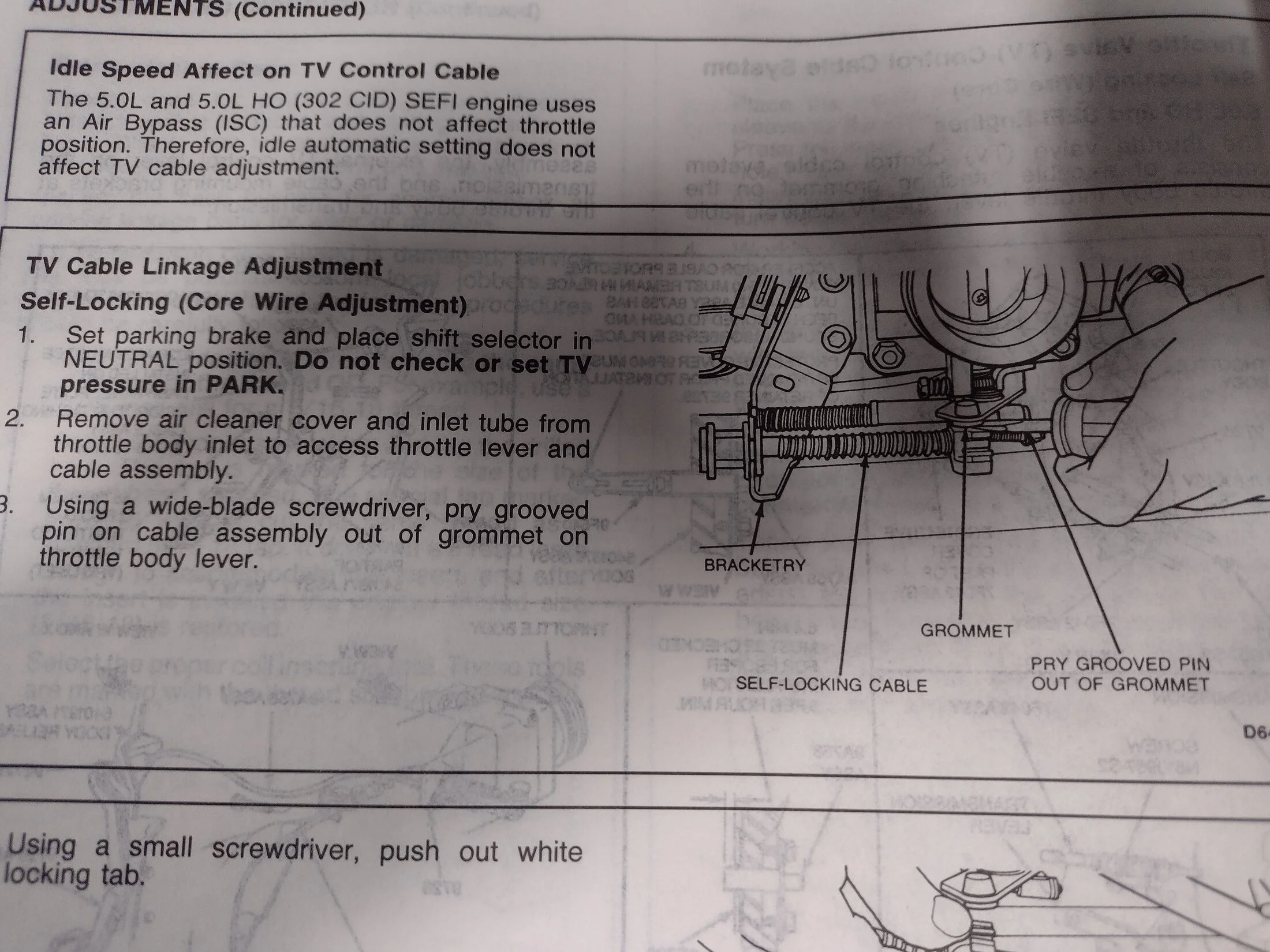

Hey everyone!
So I'll be replacing my stock AOD tv cable because the accelerator ped is stiff. I've narrowed it down to the cable.
I found a "good" used one supposedly. My 1990 Ford shop manual shows two ways of adjusting it. Most say you have to do the pressure test. Be here Ford states two options.
From what I gathered, if during moderate acceleration the transmission shifts into 4th or overdrive at around 40 mph, then it's setup pretty good.
Anyone else do it this way?
Thanks again!

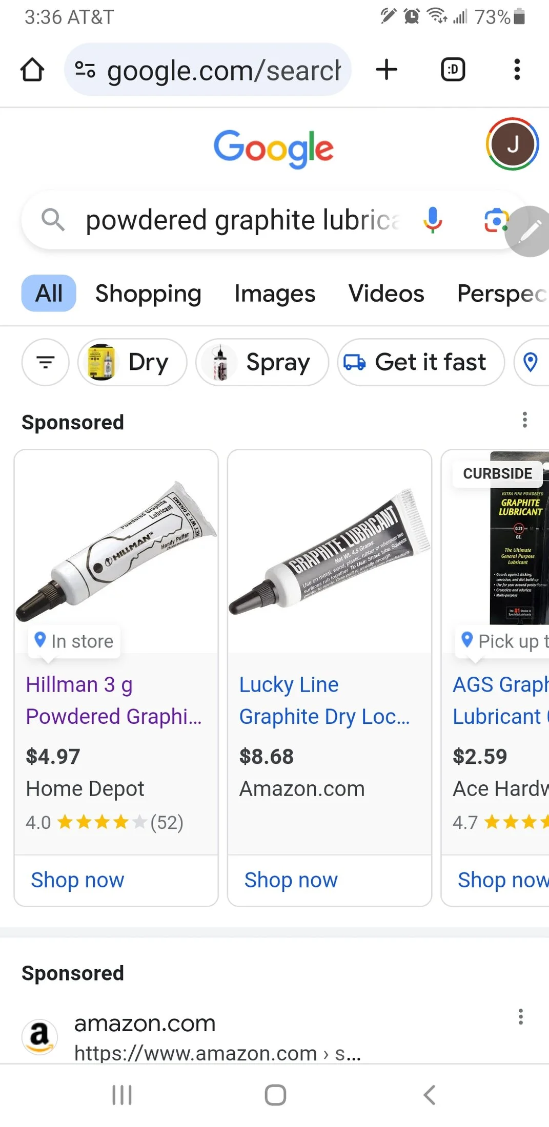

No I haven't tried that yet. I think it's definitely worth a try. I also purchased another stock OEM cable. What is this graphite lubricant you speak of?
Powdered graphite. Commonly used as a lock lubricant. Available at any hardware or big box store near the locksets. Or Amazon.

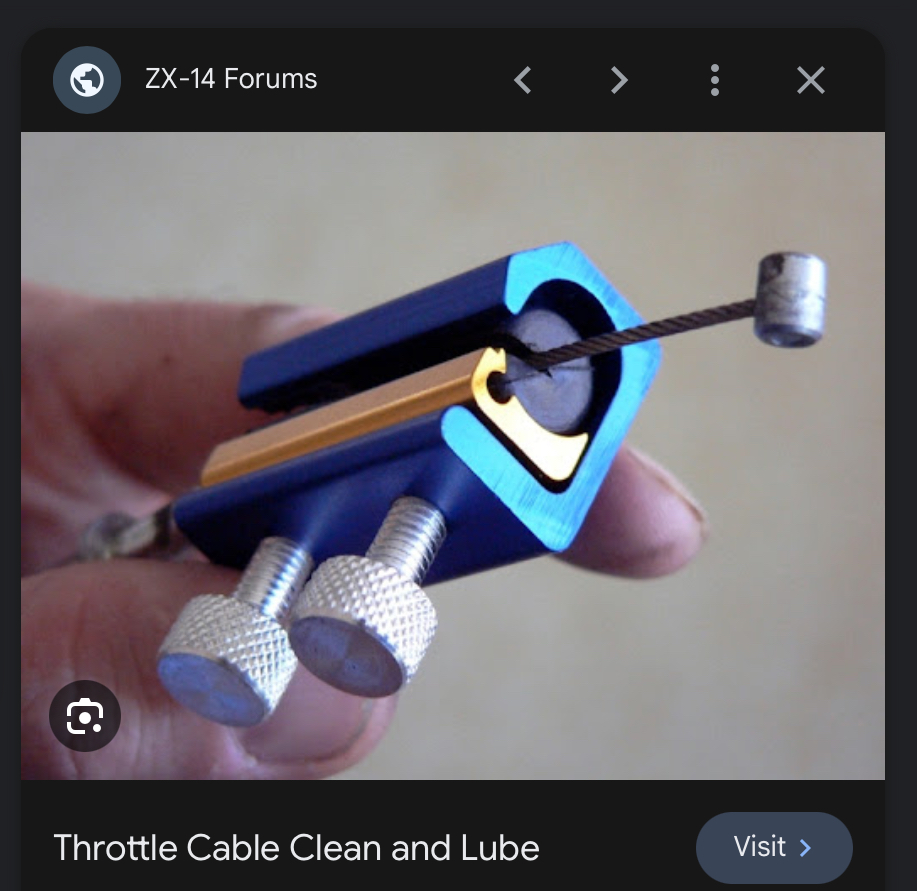

Most of the motorcycle cable lubes have a very small metal tube that will allow you to spray into the cable housing, alongside the cable....
Reactions: 91GTstroked
Thanks for this. Excuse my noob questions, but do I just squeeze some inside the cable casing? I assume it's hard to get the whole inside of the cable lubricated?
Clean as much of the inner cable as you can with Isopropyl Alcohol. Then work the lubricant in as much as possible.
I never knew about the motorcycle cable lubricants. That looks like a good option.
