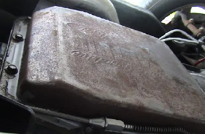

here is one of the pictures i took of the tranny pan for you guys to see.

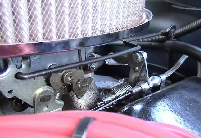

and of the rod from the pedal to the carb

No Idea. Probably best to give them a call and describe to them what it's doing, they might be able to give you a ballpark figure. My experience is that autos are never cheap to fix, but unless yours is making wierd noises then it might just be a tuning issue (if there is any tuning with AOD's :shrug: )
The AOD will not have a removeable Bellhousing, you can check for that too.

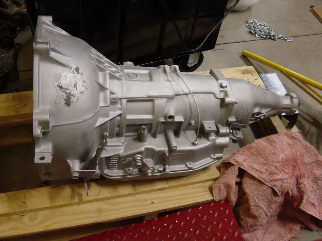

Do you have the overdrive delete solenoid? It is possible you may not be getting into first gear. If I don't have my solenoid powered it won't go into 1st gear no matter what my linkage says. Could tell us what speed you are going when it shifts?
It sounds like you are getting into first. Do you know if you have an overdirve delete solenoid? From what I understand this controls the valving in the tranny that keeps it out of overdrive. A quick way to tell is to locate the driver side rear of the pan. From there go up until the housing that the pan bolts to returns to the main body of the tranny. In this area you should find a single wire coming up out of the case.
At this point you may want to give Lentech a call.

Why would you want an overdrive delete on an overdrive transmission?
From what I've heard, if it isn't shifting properly, make sure you're TV cable is functioning properly. If its not, adjust it and if that doesn't fix it you're AOD is likely burnt. Running with an improperly adjusted cable will kill it very quickly.

The "proper" way to set up your TV cable is to take it to a trans shop. They should hook up a pressure gauge to the line pressure and adjust it based on the reading.
The "Do-it-yourself" way is to make sure that there is NO slack in the cable. Also there HAS to be 1:1 movement between the carb lever and the TV lever. Meaning when the butterflies are fully closed the TV lever must be at the "zero" position, and vice versa (Wide open=wide open)
