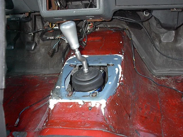

On the trans tunnel, on 5-spd cars, is an extra peice of sheet metal.* It raises the tunnel up about 1" and gives the inner shift boot a solid place to bolt to. On the AOD cars, the shifter just bolts here, so the extra height is not needed.
When 99% of people do 5-spd swaps, they don't tack weld this extra part on. As a result, the shift boot sits lower and fits tighter on the shifter. Not really a problem though, just an easy way to tell if the car is swaped.* I think i've only heard of 1 person actually taking the time to go to a junkyard, cut out this peice and tack weld it in.
I tried to find a pic but can't.* Basically it looks like a small box welded to the tunnel . If all you see is the trans tunnel, then you don't have it which is the most likely situation.

a picture of a hump attached correctly to the floorpan...I cut this out and sold it to the guy who installed it
look carefully at the center and you can see the original tunnel metal under the top blue piece.
