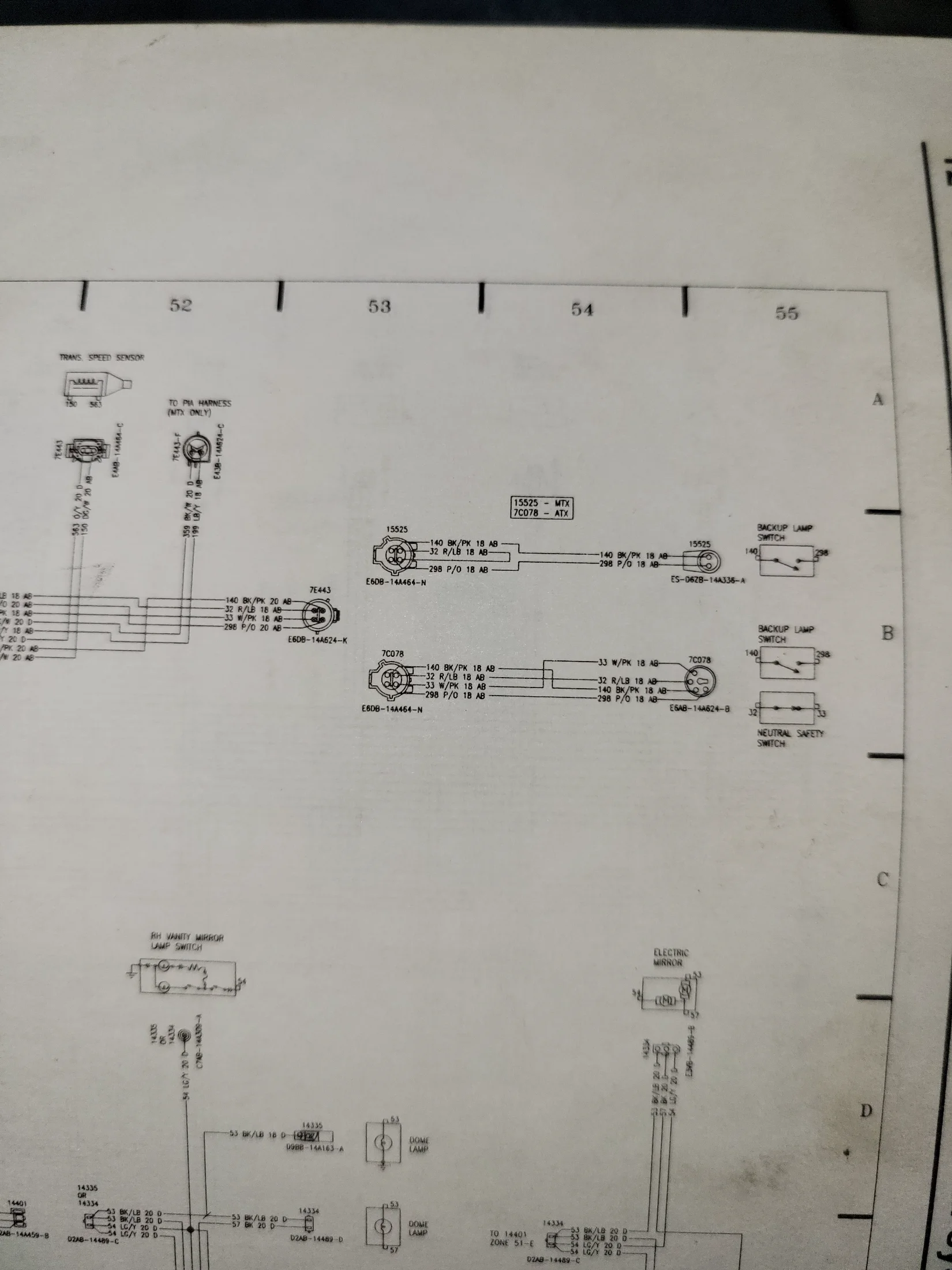

On the AOD, the neutral safety switch is part of the connector with the reverse light switch under the car in the tunnel. When I did my AOD to T5 swap in my '90, I just jumpered the neutral safety switch at that connector. I had a trans from a '97 V6 which didn't have the switch in the trans cover. I have had no issue with doing this.
As far as wiring changes, I did nothing wiring wise. I even left the clutch interlock switch jumpered - AOD cars have the switch from the factory but there is a jumper wire to prevent its use. Is it ideal, not necessarily, but I'm the only one that drives my car and I know these things are in place.

Thanks for the reply. I’ll have to get back under the car and see if I can find the neutral safety switch. Which wires need to be jumpered?
You can see that in the manual trans configuration that wires 32 and 33 get jumpered.
