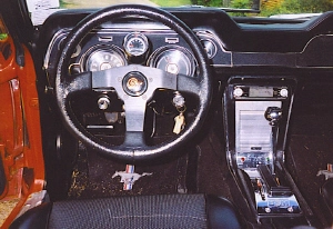

I did the AOD conv in my 67 fastback, I bought the AOD from a friend of mine for 600 and put it in with his help. and yes you do need to have the driveshaft modified, And I don't think you can use your stock shifter, but I'm not positive, I got the linkage and stock shifter from a 87 and used it until I had my B&M Ratchet put in. But make sure you get the AOD conv throttle linkage and put in correctly. That cost me a rebuild... Heres a pic of the shifter... I love it
O and be ready to beat that tunnel
