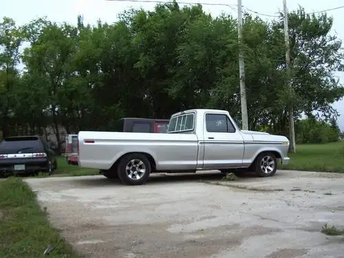

I use it as a loaner vehicle and I like shifting but some can't, won't or other

well after much debate with a ford friend here in town the C6 and the AOD will be on the market in favour of a 5 speed as he has all the stuff for the swap with the 3.00 gear set I have in the rear it should pull some good mileage and be reasonably sturdy
