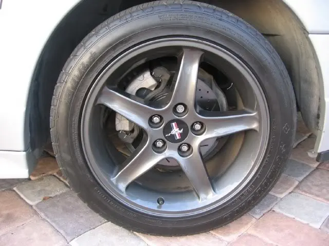

I recently did a post with this picture with a wheel question and was wondering.
if possible can anyone tell me a little history on these brakes?... are they cobra converted, or just big aftermarket brakes, ideas on what brand?
New '00 GT with LOTS of goodies and i'm still trying to figureout everything.
All I know is that these brakes stop on a dime :nice:

If you convert to the Cobra brakes do you have to change wheel size? Also are the Bullitt and Cobra brake kits the same thing? I saw the Bullitt kit somewhere and the rotors are red and say Cobra. I want to upgrade to the Cobra but want to keep the stock wheels.
Do you have 17" bullitt wheels?? If so they you are fine. The 13" brakes fit all Ford 17" Mustang wheels.
Yes, the Bulllit, Cobra, and Mach 1 all use the same front brakes. They are just painted different colors. Mach 1 brakes are usually the cheapest since they are just plain black. www.buyfordracing.com has the cheapest prices
