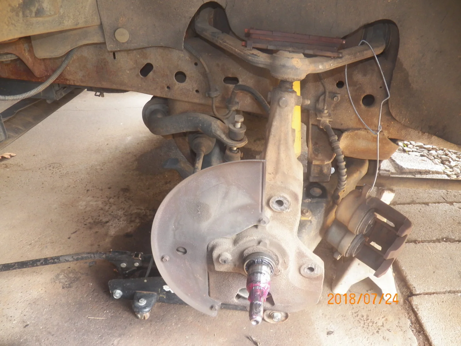

Her is a picture of the 1995 to 2001 2WD left front suspension

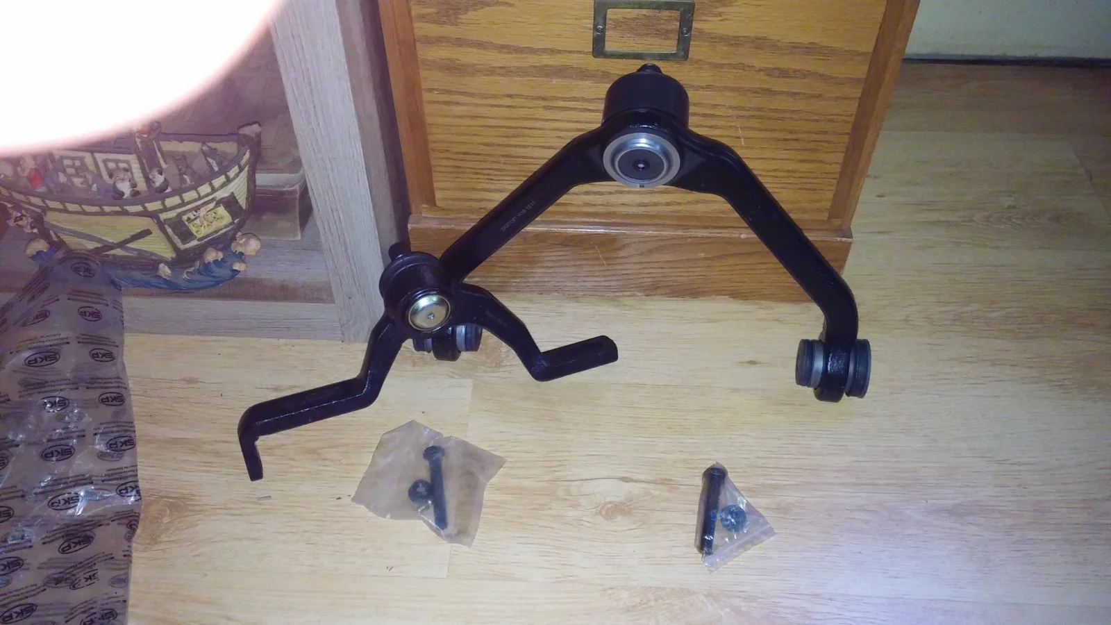

Here is what replacement uppers look like. RH is the smaller one LH is the bigger one.

Here is a picture of how different. 1995 to 2001 2WD left front suspension
There is always the "Good 'ol rEdNeCk way to do this...Remove the Explorer body, Strip the stuff off of the bottom of the Mustang and fasten it to the Explorer frame
Wow, yes. Definitely different. THANKS FOR THE PICTURE. I am not ready and willing right now to do a body swap. Great idea though. Let me find a random winning lottery ticket tumbling in the breeze and i certainly will, hahahaha.
