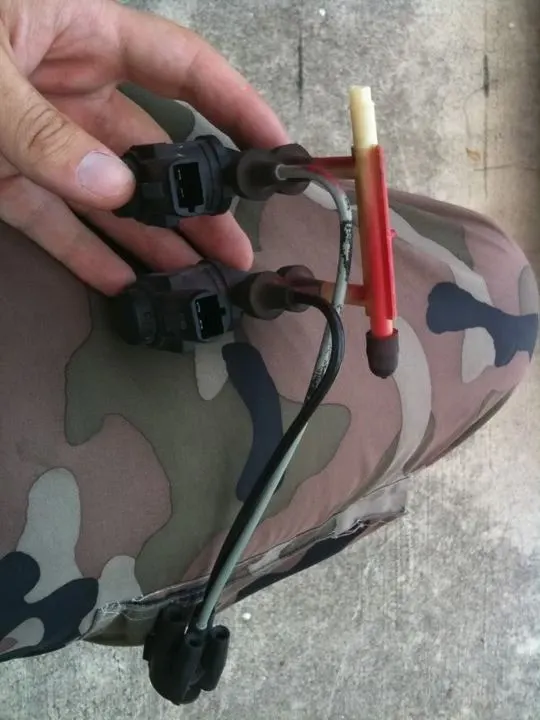

Cant i use the tweecer to disable it in the computer instead of doing this resistor ****?
my TAB and TAD were never hooked up to anything in the exhaust before, and i wasnt getting codes.
but they were plugged in.. one had a screw in the end of the tube... the other im not sure what it was connected to

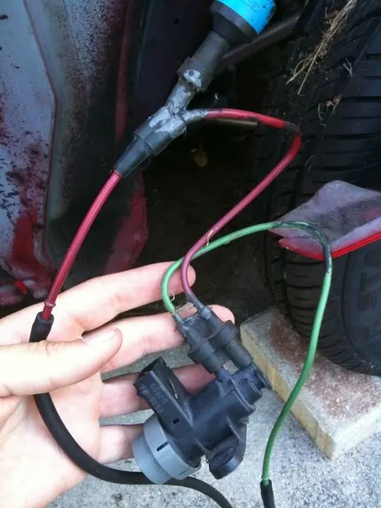

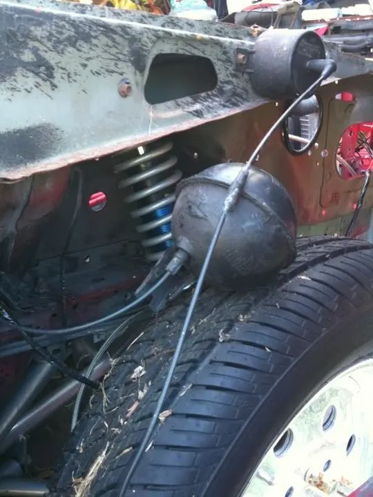

I know one of those is the vacuum resovoir.. pretty sure its the round one, but whats the cylinder shaped one for?
Also, what is this solenoid?
Whats it connect to? Is it needed?
Im pretty sure either the green or red one.. whichever was longer, goes to the EGR on the throttle body, and im THINKING the other one went to the port with the TAB/TAD soleoid tree pictured below.. but its been years since i had this car together, so i cant honestly remember.
If so, i guess ill just cap that end off, right?

I also confirmed one of my own answers, sort of.
still not sure where the other end leads to
but this is "86-93 EGR VACUUM SOLENOID, 5.0L"
so im guessing the green tube runs to the EGR on the throttle body...
and the red tube USE to run to the TAB/TAD tree?
so ill just cap the red tree?
also, im unsure what the cylinder shaped thing in the first picture is
Oh the last photo, yes that is for the EGR isnt it?
yep.. thats for the EGR..
i guess ive answered most of my own questions
im just curious what the thing in the first picture is
the round ball, im 90% sure is the vacuum resovior.
but the other thing, in front of it closer to the nose of the car
no idea what that is.
but all this stems off of it i guess
oh ok, ones for the a/c
and ones just a resevoir.
so the diagram says.
i guess all my vacuum issues should be solved. thanks guys
