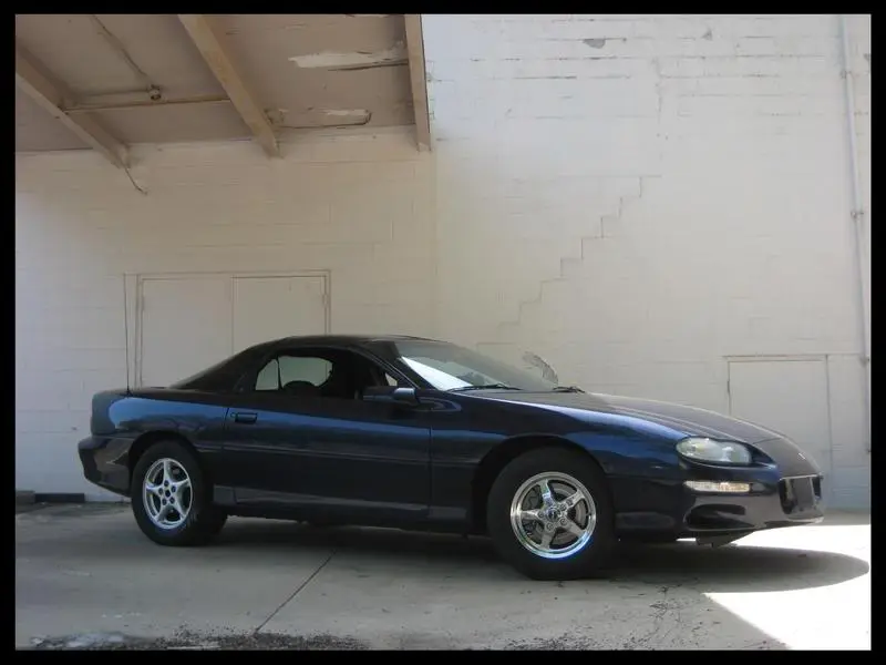

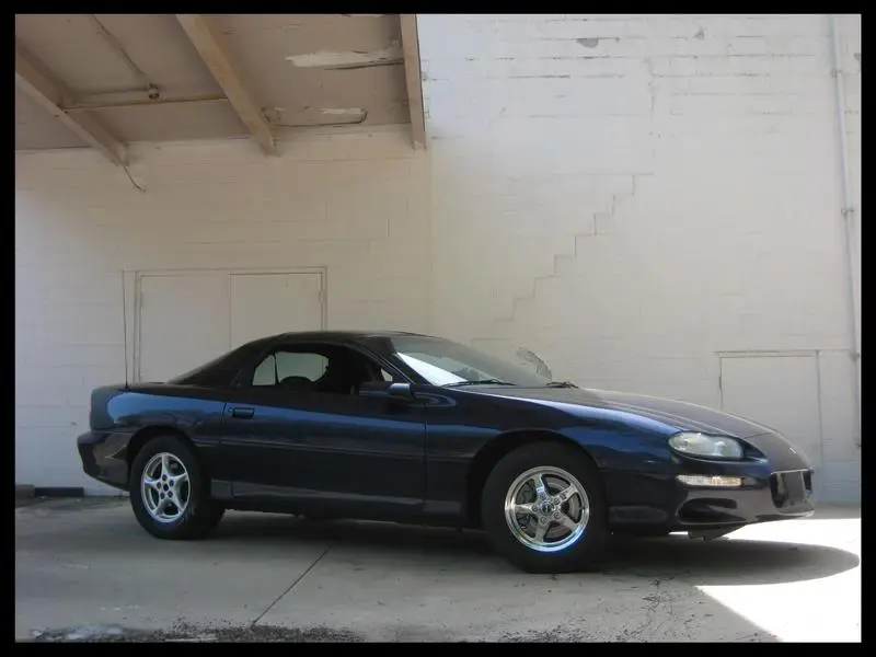

i was actually thinking of going with the greg weld 17s dragstars originally for the front.
as far as i'm aware the racelite 17s will bolt right up i was going to go with a set of them but i wanted them for a good drag set up and i wanted more sidewall.
they make em in 17, 18s, and 20s.
