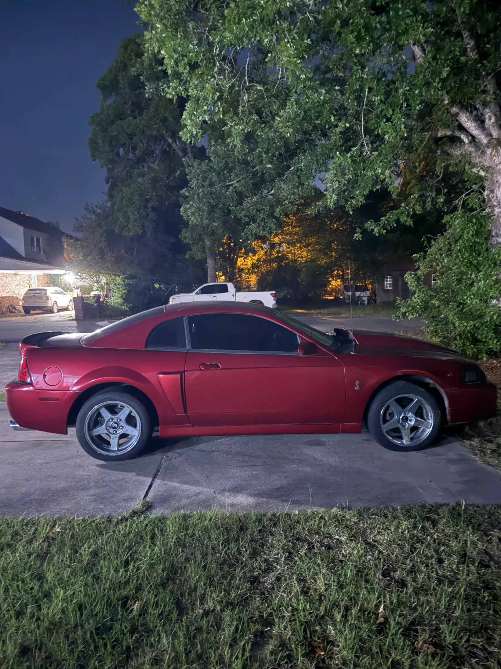

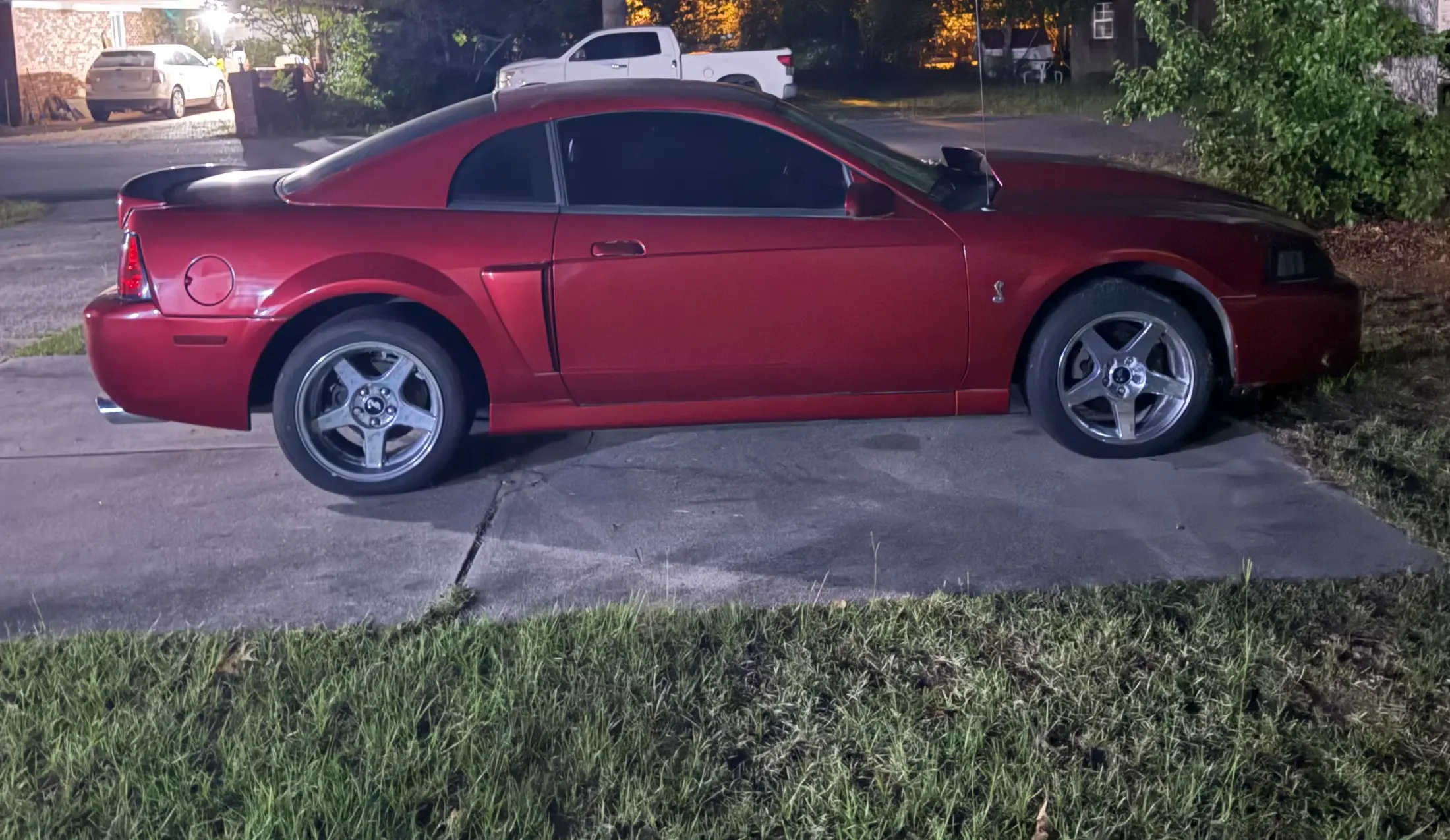

The front tires are 245/45zR17. Here is a picture of it from the side can you see the gaps it looks crazy

100% lower it. Springs of your choosing (at least a 1.5 drop IMHO) and some good caster camber plates- Maximum motorsports 4 bolt - buy once cry once.
If you want a tad lower and don't mind a slight creak once in a while, lower without isolators to get another 3/8-1/2 inch.
I wonder if it has drag springs or something on it, that seems like it sits high even for factory - but I've not had a factory height car since 2004 lol.
Reactions: Cassiebaebae
Yessss it looks so weird i def. want it lower. I dont know much about all this but been trying to get my friend to help me figure it out. I seen some 2” springs is that to much?
Depends on how rough your roads are and how much attention you pay. If careful and not trying to off road 2 inch is perfectly fine and will make it look a ton better.
Depending on miles you may look at ball joints and other wear items as lowering will speed up failure on prior worn parts. But don't skip the caster camber plates.
