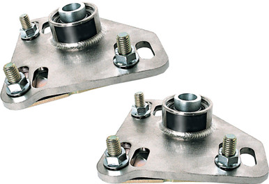

You have options when it comes to CC plates. If you don't plan to use coil overs now or in the future, you can use 3-bolt CC plates. I've used Steeda 3-bolt CC plates for over a decade, and they've worked very well on my autocross cars.
Steeda's instructions are clear and available online. It's a good idea to look at the instructions for any of the CC plates you plan to buy.
I've purchased, but haven't used, a set of J&M 3-bolt CC plates for a future project. I think they're a good, relatively inexpensive option. J&M's instructions aren't as detailed, but I've had good experiences getting answers from J&M via email.
American Muscle sells the J&M CC plates:

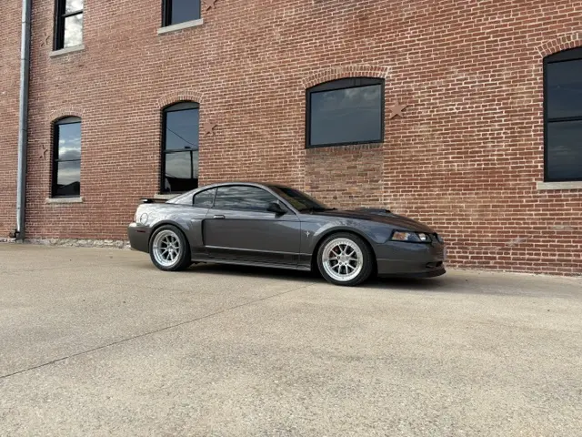

The front sits on eibach sportlines with NO rubber isolators - to get it lower. Tires are factory height (25.7) on front. Roughly a 2.5 drop all around on it.
Rear of my mach is on sportlines in this pic but uses a Lower control arm with adjustable spring perches.
Worth noting I drag my prochamber mid pipe a LOT.

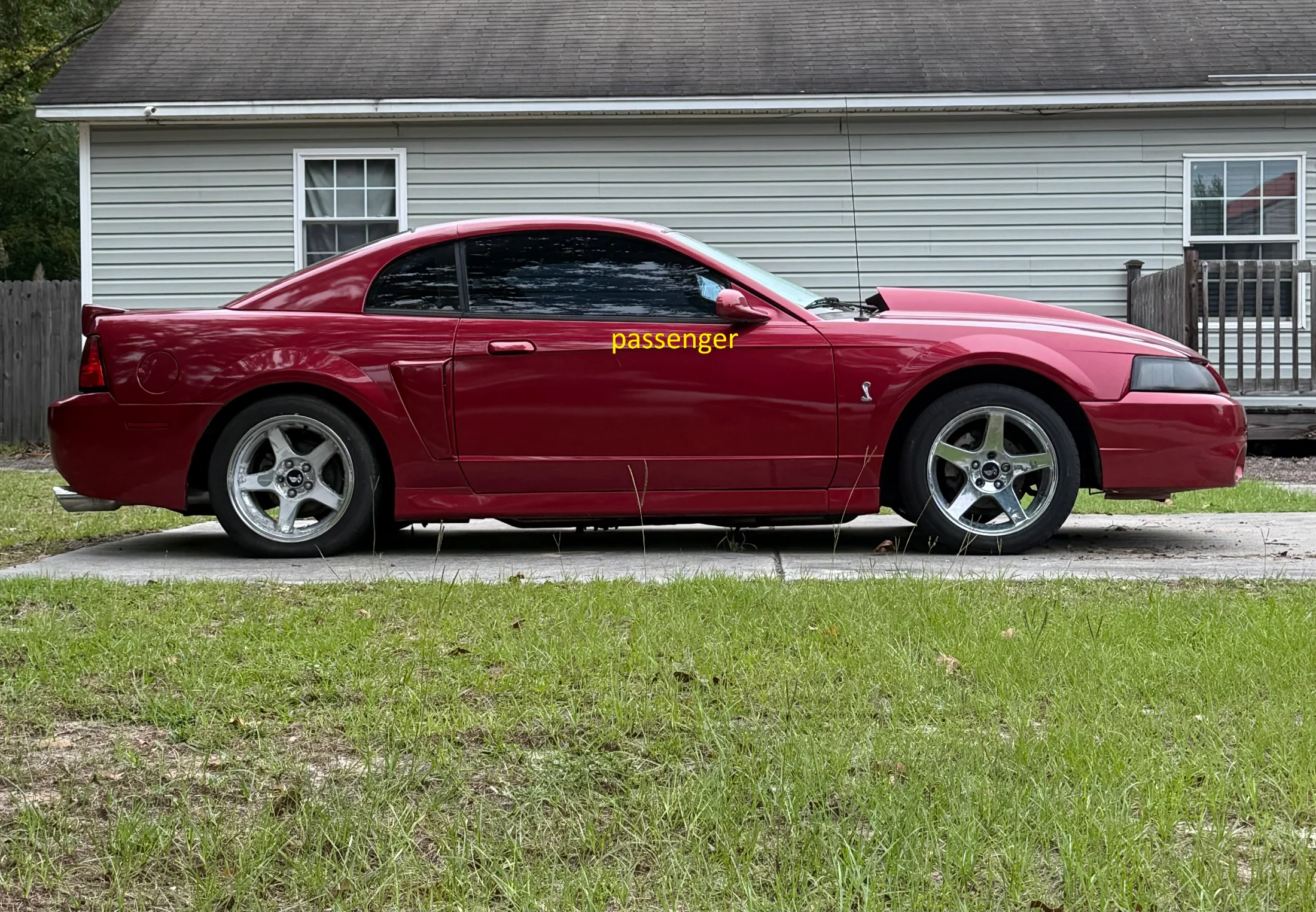

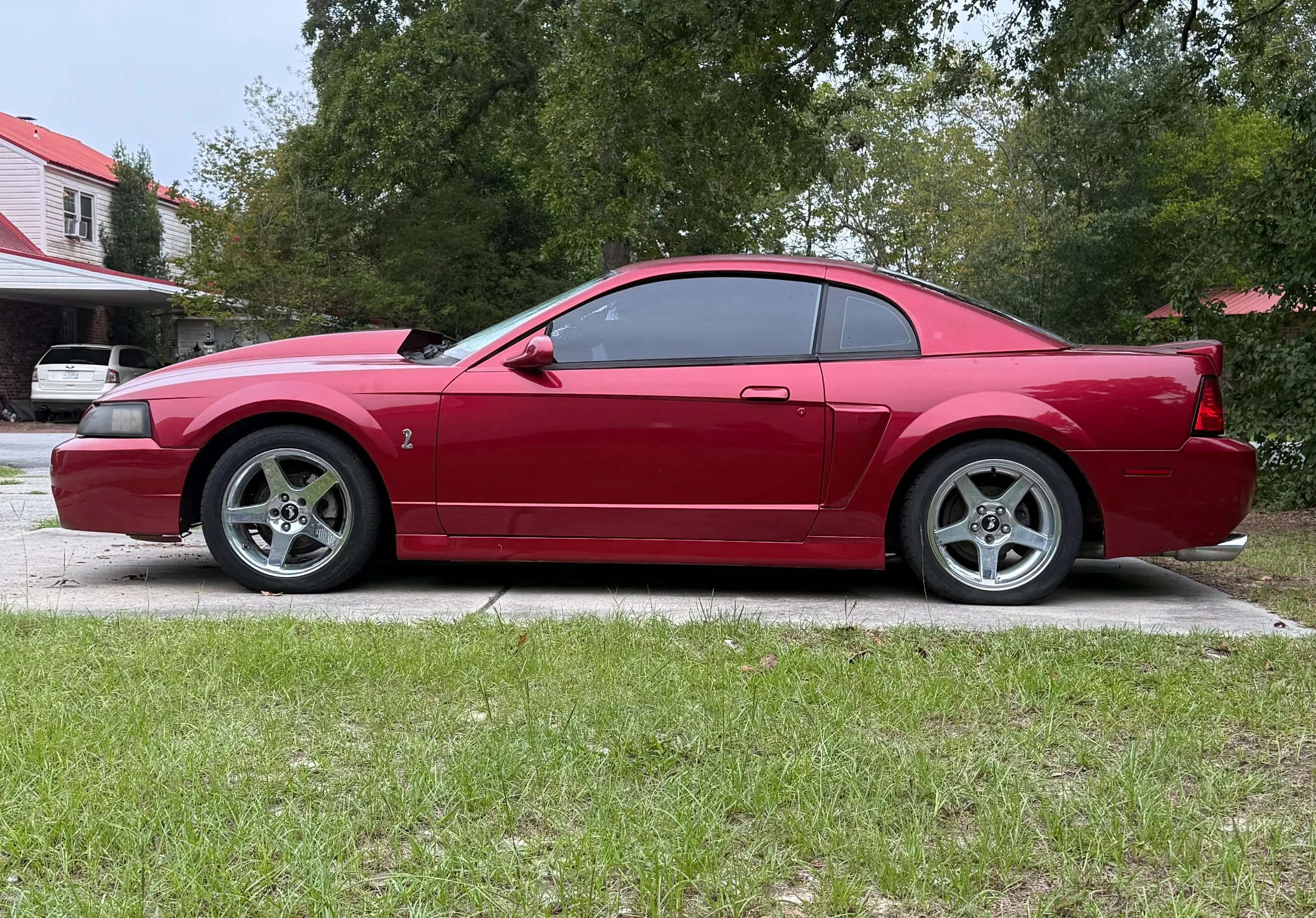

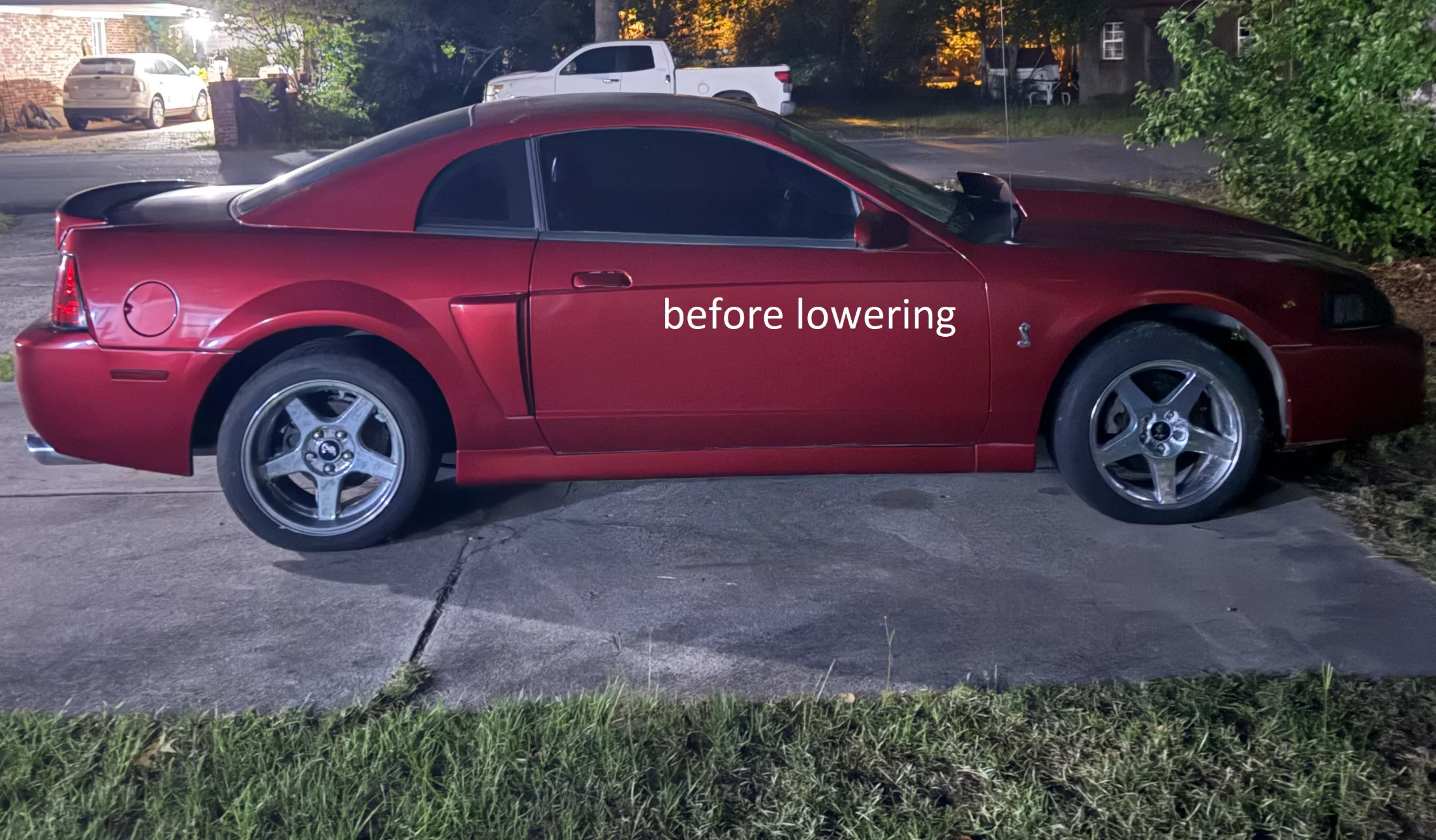

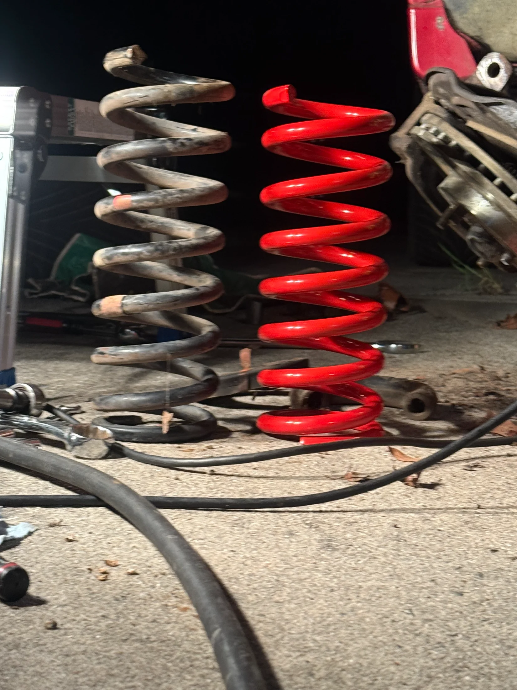

Heyyy, Ok I haven't been on here in awhile but my dad was able to get my car lowered ( 2.25" front 2" back ) last weekend but something isn't right. Its not what I thought it was going to look like or something is wrong? can someone help me please? I'm going to upload some pics of the car and some measurements of each tire I think i measured it right (from the tire to the inside of the fender lip?) sorryy I'm new to all this and my dad isn't really familiar with mustangs so here I am LOL. (Driver Front 2) (Driver Rear 1 1/2") (Passenger Front 2" 3/4) (Passenger Rear 1-3/4) What Is wrong? does anyone maybe know what we done wrong? if i left something out and you need more info please let me know thank you in advance. they have the insulators on the springs too.
