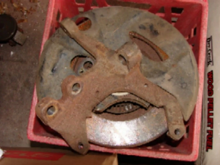

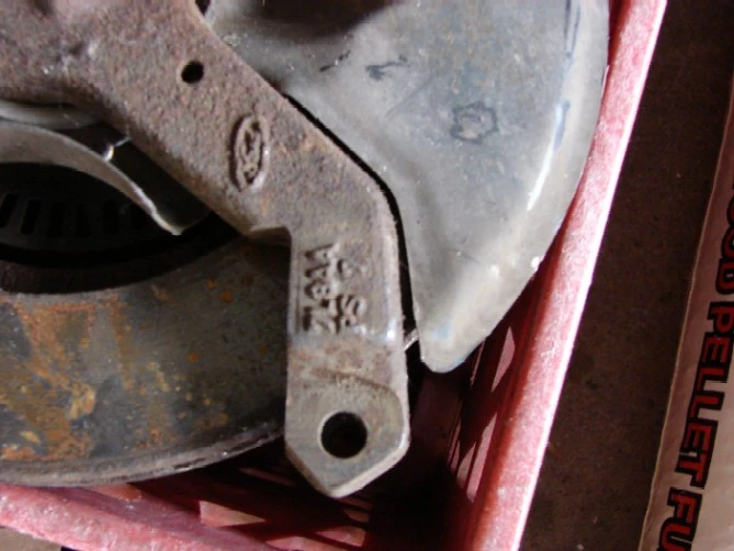

I picked these up at a swap to go 5 lug on my Fox. I'm guessing some kind of sensor goes in the hole and reads the little slots? Where would the P/N be? I have a pic of the cast #
94-302-vert Active Member Aug 16, 2004 1,947 2 36 NE CT Apr 30, 2007 #2 Apr 30, 2007 #2 It looks like mine... But I can't be certain.

Those are 96+ spindles, straight tierod arm. The 94,5 ones have a curved arm. The sensor hole and tone wheel is for a wheel speed sensor (abs)

Shoot, not what I wanted to hear, taken again... Thanks for the replies guys. At least I learned something new
