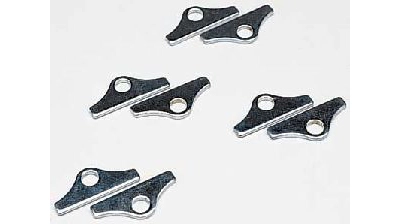

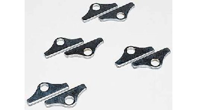

If you have stamped steel valve covers with a lip on them it may interfere with the metal gasket. Stamped valve covers tend to flex in between bolts causing leaks. The best valve covers are solid, either cast (like stock 87-93) or fabricated. They do not flex between the bolts and seal much better.
For stamped steel valve covers, the only real way to make them work is with some valve cover washers like these.
http://www.jegs.com/webapp/wcs/stor...irect&categoryId=18025&parentCategoryId=11221
They provide increased clamp load over the valve cover and help keep the cover from "bowing" or "flexing" in between the bolts.
I do not care for stamped steel covers for this reason.
