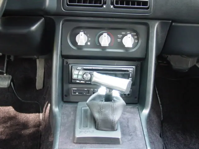

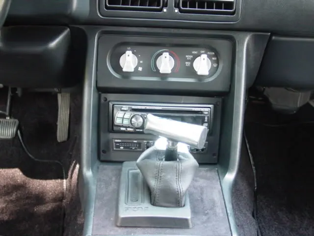

Ok, pictures are here.
I'm pretty happy with how things turned out. I may try and trim a little more, just to see if I can actually have the console not touch the shifter, but it doesn't seem to have any pressure on it right now, so I think it's ok.
Let me know what you think...

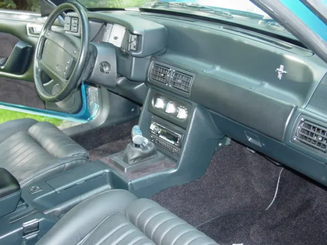

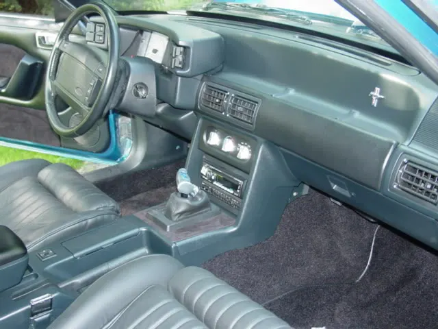

I installed the hammer shifter about a year ago and I never encountered the problem you had. It does seem like your console is sitting farther back or something. I’m not quite sure to be honest with you. My install went fairly smooth and took the better part of the afternoon to complete. Glad to see you were able to work around the problem.
Here are a few pics of mine. I swapped the handle for a different B&M handle. I am also running an AOD until I swap it for the C4.
