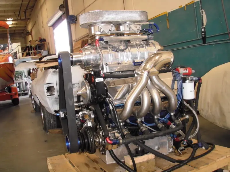

622 ci merlin block. 14-71 blower. Dart cnc Heads, Fuel injection....etc etc etc. Should make around 1100-1200 horse and 1250 tq on pump gas, we'll see soon. We're tuning her for reliability, we could probably get more horse but I want to try to get 100 hours between rebuilds.
