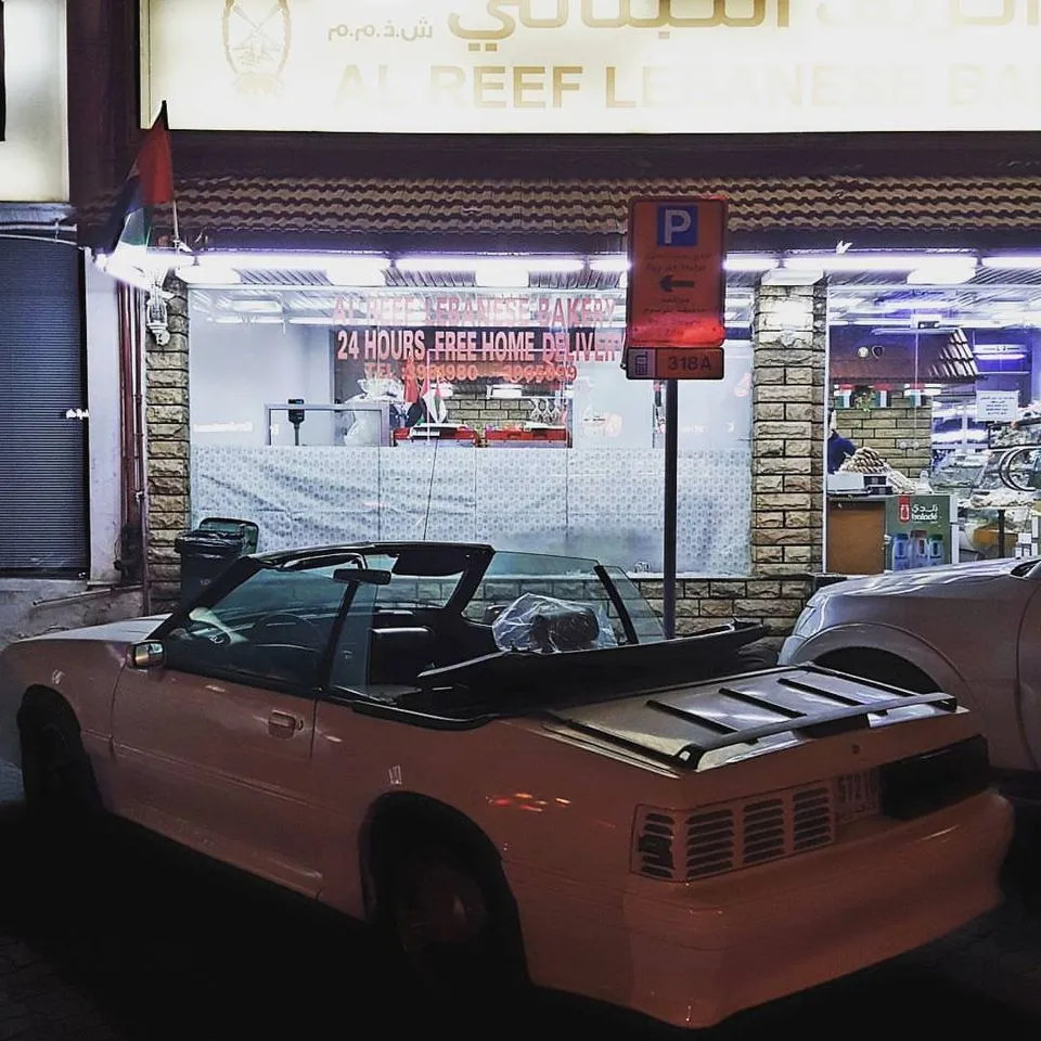

Also, lets see some pics of the car. Was this car always located in the region or was it imported? I see a ton of fox bodies located in the Middle East on Instagram, so always wondered how common they are there.

The car is GCC specs, which is from the region.. I've had it for over almost two decades now... its mainly stock though.. besides the air filter and shocks.
There use to be way more.. but its a rare sight now.. however there are still quite a few left.. though as parts are scarce now.. it gets hard to maintain.
My car is in the workshop.. and this is the only pic I have on the desktop.
Thanks again for all the help.
