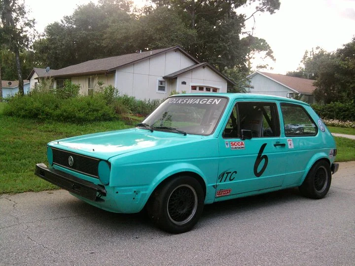

Im not an expert but I do occasionally run scca events in a full race Volkswagen rabbit...my phone is being a tard and wont let me post the pics of it on here...gimmie a bit and may've it'll cooperate...

Finally got it to work...

PS: That VW looks like a whole hell of a lot of fun.

Thanks....its a ton of fun...not the fastest thing on the planet but hella light and handles insanely good....
