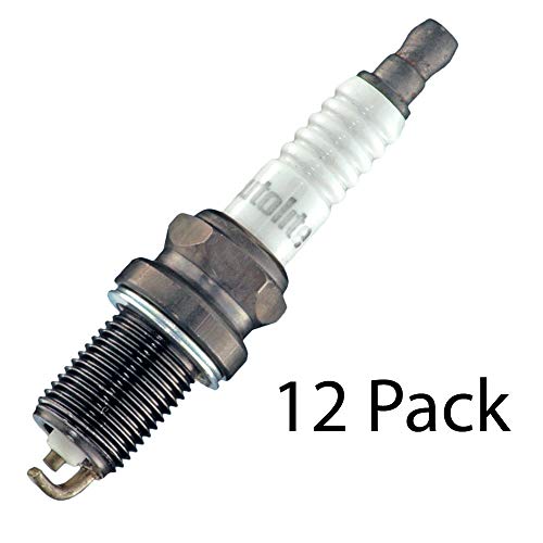

Where did you find them?
Appears legit so I guess we will see.
Reactions: Blackhawkxx
I just ordered 16x 3923s for my rig from O'Really?...
I didn't want to screw around with, "Maybe they're legit but not certain" scenarios.
If they're no good, they go right back to O'Really?.
Besides, the other site didn't have the 23s.
