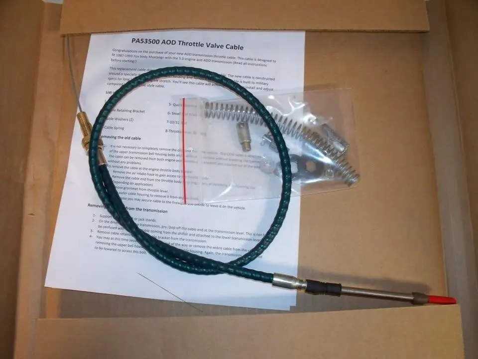

Ok Install took about thirty minutes longer than it should have. After playing around trying to get the cable into the bracket on the transmission I found that the whole bracket can be removed and made the job tons easier. Total time spent 45-50 minutes.
Here is what the kit looks like.

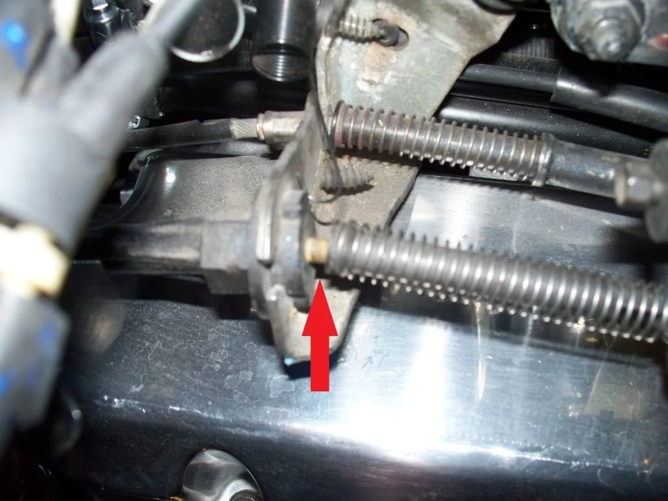

Here is a picture of the the main bracket on the transmission remove this 9/16th bolt and bracket comes off so you can use two hands otherwise you are fighting your exhaust to get to the little bolt in next photo
This little 8mm screw needs to be removed and a clip installed then reattached to the big bracket.

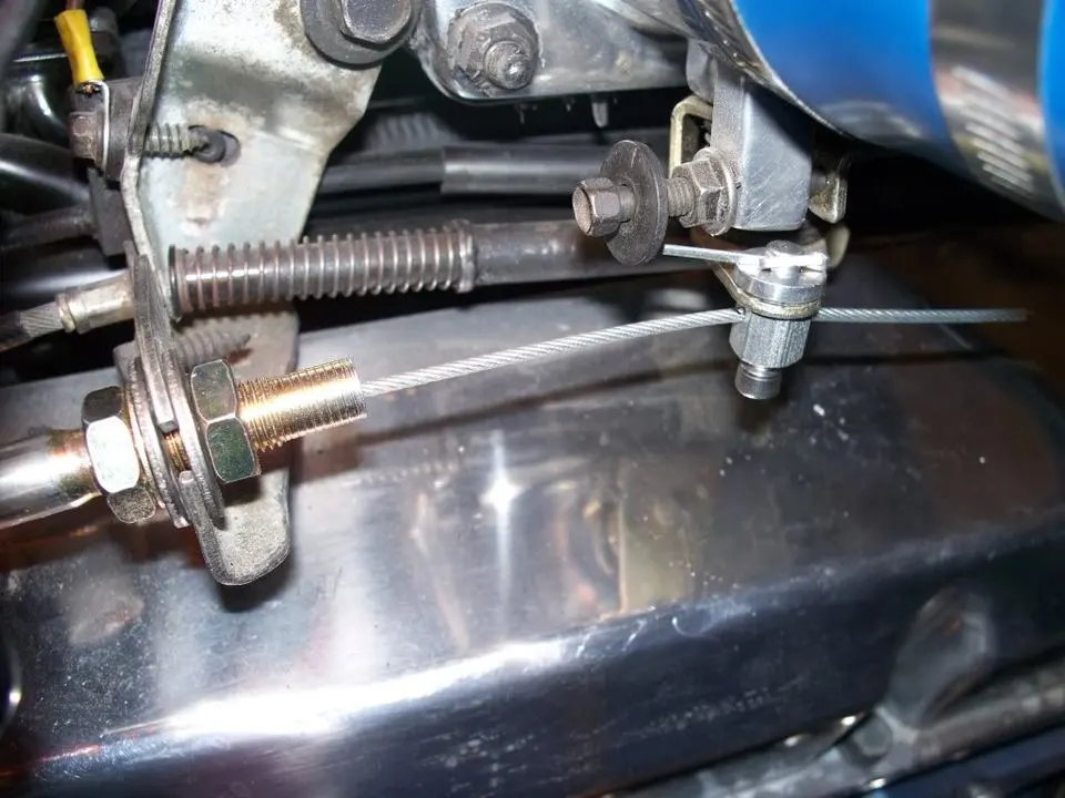

Slower shift points or holding gears longer can be acheived by adjusting the cable 1/8th of an inch at a time from the stock point. easy adjustment back allen head off pull on cable 1/8 inch then tighten allen head.
